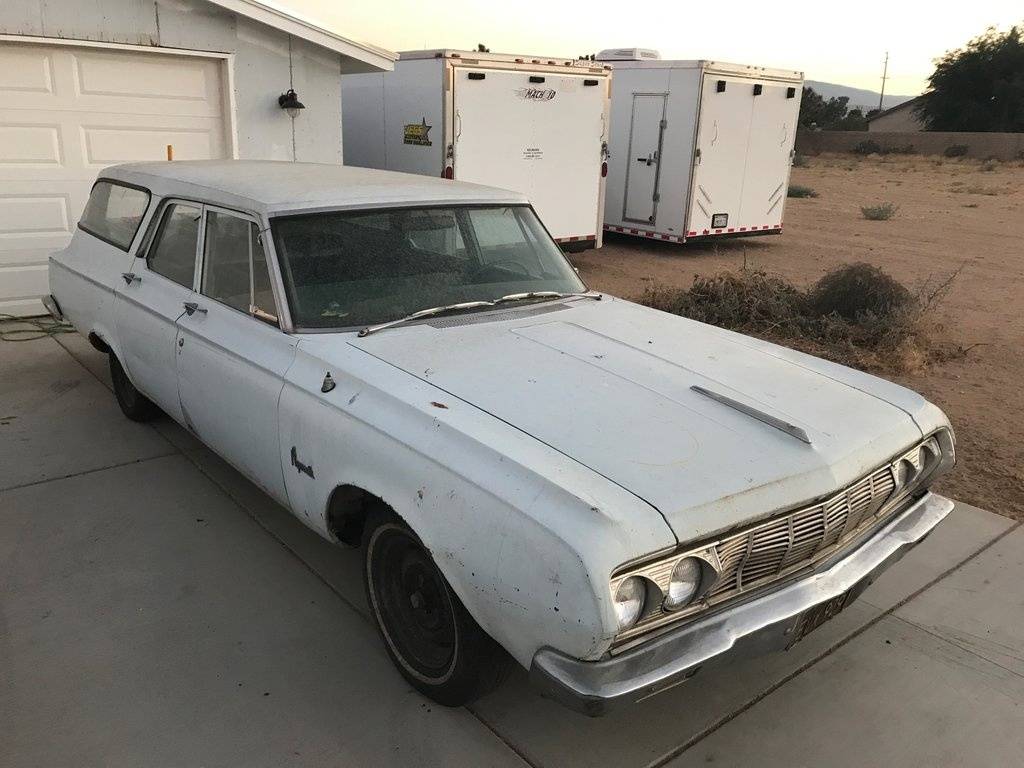

hey guys,
Just picked up a 1964 Savoy Wagon. The only option it has is an electric rear window. My issue is the motor has seized and the window is stuck down. Does anyone know how I can get the glass and/or mechanism out without breaking anything? Any advice helps out.
Thanks
