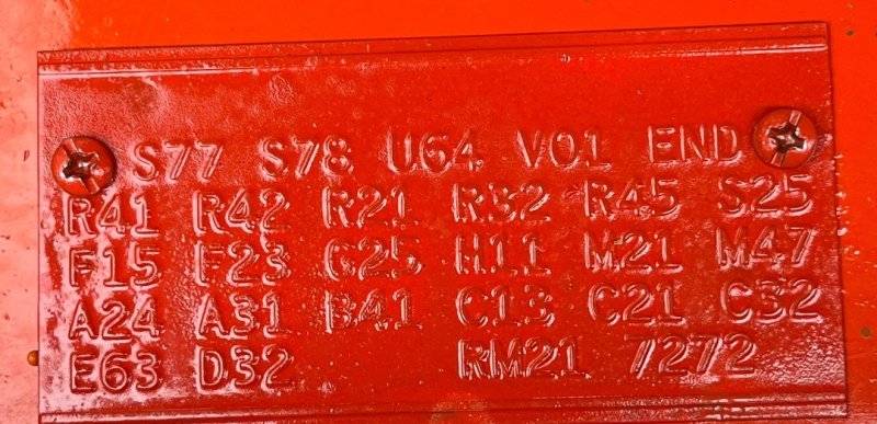

Hello. My buddy is looking at purchasing a 1969 Roadrunner and hasnt figured out what R41 and R42 are on the fender tag. I cant find the info on any of the decoders either. Anyone have any idea? Lynch Rd. car based on the VIN.
RUN in the other direction. Bad deal there
If you run the numbers in a decoder you get this. 400 in a 69 lol Not 100% sure i did it correct. Right to left bottom to top right?

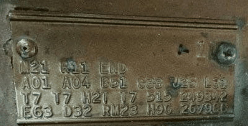

That doesn't even look a little bit like a 69 lynch road tag to me. It's as phony as a Joe Biden three dollar bill.
The tag in post #8 looks like a legit St Louis tag. But it doesn't look my my lr tag either.
If you wanna see how a 1969 lynch road tag is formatted, go to A12 discussion forum. See the thread "RM21M9Axxxxxx my old car". Post #2 shows a legit L.R. tag, for an A12. Same format for all lynch road b-bodies.

No offense.... but that decode is wrong in so many ways, I'm not sure I can find them all.
Thanks everyone for affirming our suspicions! Figured something was up!
