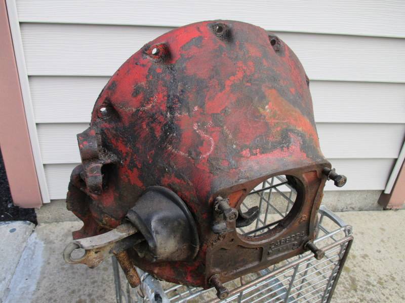

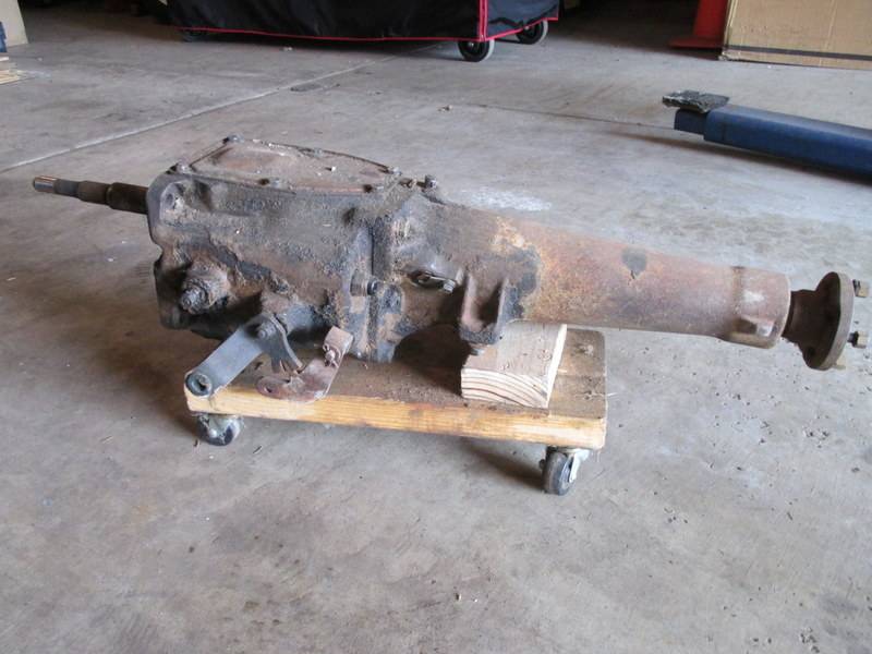

I have a flywheel & bell housing if you decide to go stick in it. Also have the 3-spd tranny for it.

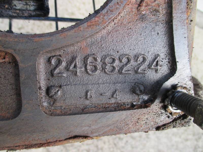

The intake I have is 2465726. I might sell or swap it if I came across 302 heads and ld4b intake.
