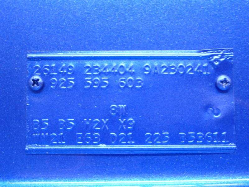

I have a 69 Roadrunner, 383, 4 sp, all numbersmatching. It was repainted before i bought it an the hood is all B5. Is there any way to tell from the fender tag if it should have the black stripes?
V21 would be the option code on the fender tag for performance hood stripe. Lynch Road built cars don't list many codes on their tags, so if made there, it may not be stamped.

…Lynch Road built cars don't list many codes on their tags, so if made there, it may not be stamped.
@hun2elk, this is a new one for me. I have an “A“ built ’69 myself. Can you elaborate on that some more for me?
Lynch road tags generally are very limited as to what options were stamped into a fender tag. The broadcast sheet basically had all the options info. Second line from the top on the tag, told which engine assy, trans assy, and rearend the car got (including the brakes). If the option needed a specific hole drilled for it, it got mentioned on the fender tag.
The L.A. and St. Louis built cars had more options info on the tag.
Lynch Road tags were sparse to say the least...
