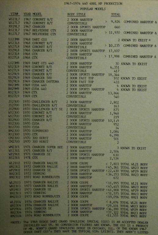

Maybe this will help?
I have a few old books lying around and found this?
45,361 1972 Chargers with WH23U2 Body
Source: Moparfan.com
The WH VIN tells us it's not an SE (WP VIN) so somone threw in the emblem.
~165 1972 Charger WH built with 440-4 and A36
Where do you get a number like this. I thought you could only could tel lhow many cars with a certain drivetrain or a certain option. Not combine them and get a smaller number?
Larry
GG's 72 Charger Options and Accessories Report does list that breakdown.

Help me understand something....
The O&A report lists 124 440 four speed total for 72 WH23 cars. How could there be 165 in the Rallye's?
