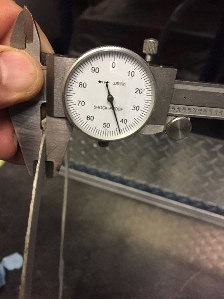

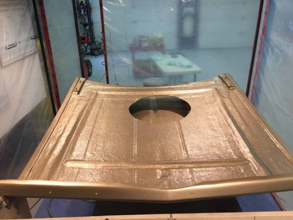

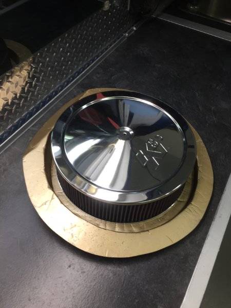

With this glass hood I had originally cut the hole for a 14" element. I increased that to a 16" and here is the leftover piece from when I opened the hole up. .044 fibreglass thickness. Imagine a 5" hemi scoop bonded to that at 130+.

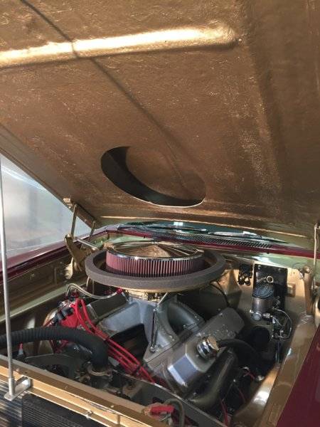

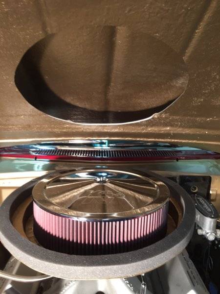

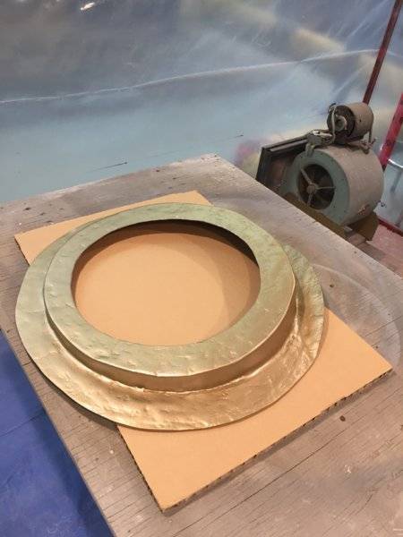

On another note my Fibreglass plenum that I made took some paint this morning. Looks just like the bottom of the hood- porous. Once the foam is applied it will seal to the hood nicely. The problem with this design though is that more carb spacer will mess things up. Will deal with that when that time comes though.
Update:
The fibreglass plenum in finished form.
Seals tight to the hood all the way around, will be able to report comparisons next season. Cowl verses hemi scoop.

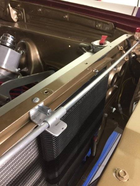

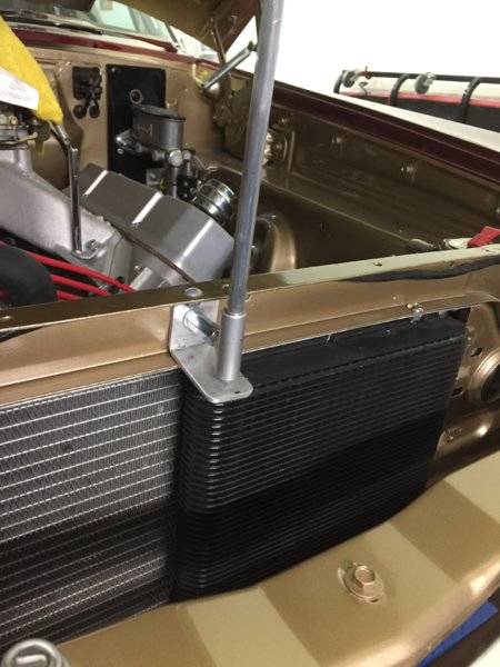

Not sure what guys do for prop rods but this is what I came up with.
3/8" aluminum rod, spins 90 degrees from vertical to horizontal position. I didn't want to use a hockey stick handle that seems to be common in these parts.

The engine it’s of the prop rod is really cool. I’ve never seen one like that. The only thing that I would question is that it’s right in the middle, where I would constantly be standing and reaching in from. (??).
:popcorn:
I’m just gonna stay here and enjoy the show!....
I tried the prop rod on the side and this hood did some weird ****. Lol.. So I moved to the middle. I'm going to try the side again now that the hood is finished and see what it does.

Looks good there Malex. I'd probably leave it in the middle. If it were on the corner it could warp some on a hot day.
