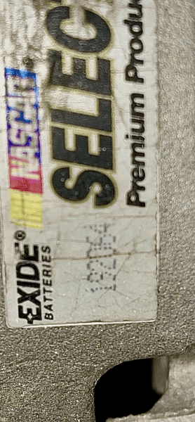

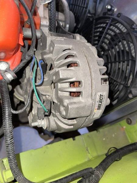

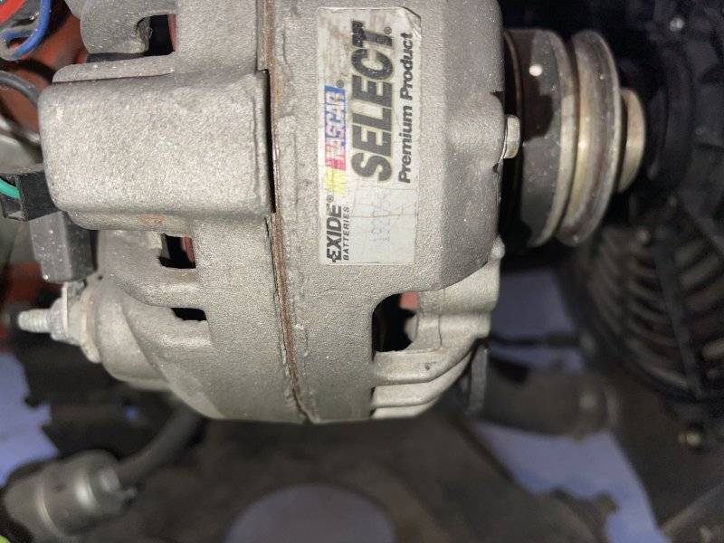

Trying to find the alternator output spec on my alternator. The Excide number is 192064. Can’t find any web information.
yOU ACTUALLY HAVE TO TEST IT WHO KNOWS WHAT IT IS INTERNALLY? 35-60-100?
Yeah since I can’t find anything on it I’ll pull it and bring it in. Wonder what shop can actually test is acceptably. Is there an RPM range that I need to give? Meaning is the current proportional to the RPM or does it hit max current at idle or just above idle rpm?
Welp I’ve found a good old alternator shop near me. Thats all they do. We plopped it on the tester and the guy said the same thing. Its a reman and probably no more than 50A if that. He controlled the regulator and spun it up. 35A then 50A then 80A and peaked at 109A we both looked at each other like wow. This is the first good luck thing I’ve I think I have had with this car lol. He said there is no way he could build a Mopar alternator with that power. A Delco yes but a Mopar nope.

The alternator should be load tested per FSM specs. Most ofvtge time, the alternator is a three phase full wave bridge rectifier circuit. But The actual amperage is determined by: stator windings (and their winding wire gauge, per slotand corresponding impedance and how their connected EITHER in star or delta configuration), capacity of the diodes, the rotating field windings and the excitation voltage and the ALTERNATOR's RPM (not engine RPM's) at test conditions. From the pixs, its a remanufactured unit that has all the original factory IDs sand blasted off. Just my opinion of course.......there are the usual expert's that will likely disagree.......

The alternator I took off my car had a double pulley for A/C on a non A/C 383 car. It was rated at 60 amp, that’s getting replaced with a 55 amp single pulley non A/C alternator.
