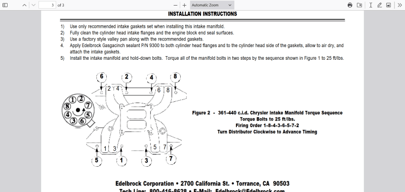

Here's the instruction sheet for future reference...
Screenshot 2024-01-13 at 08-11-32 2186 2191 7186 7193 - Performer and Performer RPM Intake Man...png
