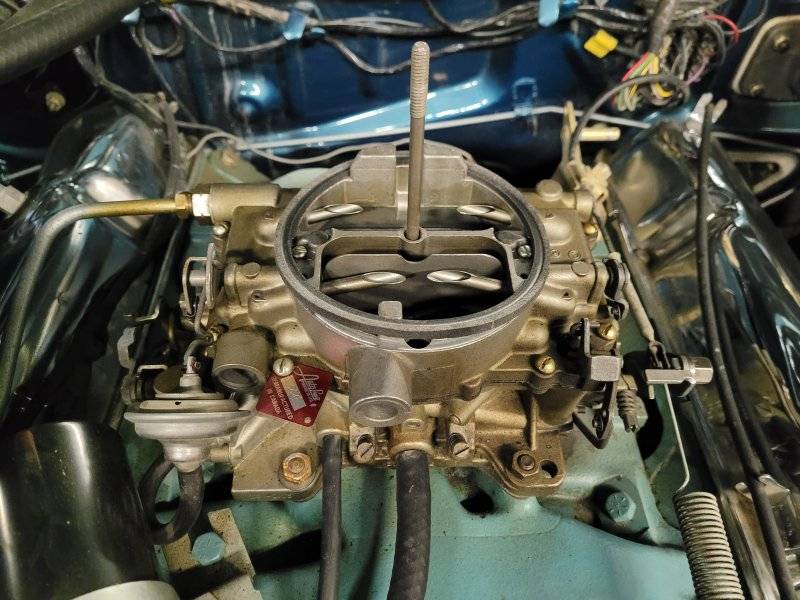

A 4299 Carter afb. Something like 530cfm .
With the stock small cam and flat intake with log manifolds it worked quite well.

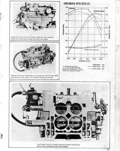

A Carter 625 AFB tested against a 600 Holley made 17 hp more, 17 ft/lbs more tq & used less fuel doing it....
