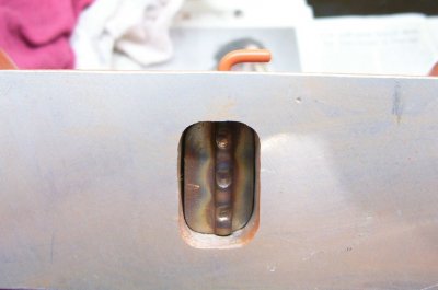

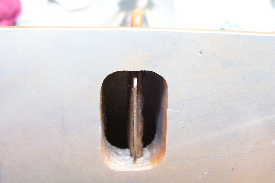

on the engine in my 65 coronet i made a butterfly valve and put it in the manifold crossover. turn the heat on when its cold, shut it off when its hot.
I don't mean to highjack the thread but could you please provide an example of the heat cross over butterfly valve you designed? I live in Fla. and the heatsoak the manafold goes through in mid summer would be greatly reduced (i think) if i had the option to shut the crossover.
i did the same thing to a ch28 intake thats not on an engine. i'll see if i can dig the manifold out and get some pic's of it. a little work but worth it if your using iron heads.
crossover
see if this works

VERY COOL!
It's one of those things that when you see it, it makes you wonder why you (me) didn't think of it in the first place.
Thanks again!
