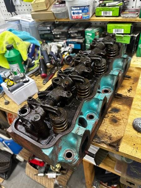

The thing STILL smoked like crazy, so I pulled the valve covers. Gave them a quick clean and paint job while they were off. The drivers side head was FULL of oil and made a huge mess when I pulled the cover. The return passages were 100% blocked, worst I have ever seen! After poking around in them, I found a chunk of a valve stem oil seal. All starting to make sense now. At the same time, I decided to run a compression test. Got great numbers on most, but cylinder 4 was a bit low and 2 was notably down. During all of this, I bumped a rocker arm and it moved… A LOT. After poking around I found three of them which had a huge gap. So much for “Just needs a tune up and it’ll be a great driver.” I pulled the intake manifold and predictably…
So this put me in a tough spot. I originally swore I would not spend more than a couple of hundred bucks on this little 318 to get it going so I could drive the car, then I would focus on getting the parts for the body/interior and engine swap. Don’t forget, this whole time I have had a 440 on an engine stand and even scored a dual quad setup for it! Either I was faced with pulling this motor and trans out and basically selling it as a core, or I could commit more money and keep trying to get it going.
I guess I am a sucker for lost causes and I have a soft spot for this little thing, as I pressed on. I pulled the heads and did a quick check of the valves. Confirmed leaks on 2 and 4 which would explain the lower compression. I dropped them in at a local machine shop along with new valve seals and they are currently being worked on. They should come back 100% solid, clean and ready for paint. That should fix the compression issues on 2 and 4, as well as the exhaust valve issues on 3, 5 and 6, PLUS stop the thing smoking like Cheech and Chong were driving. At this point, gloves are off and I have decided to make this little thing real nice. The cylinder bores and pistons look really clean so there is no reason this wont be a lovely little engine when it is all back together, so why not make it look nice?

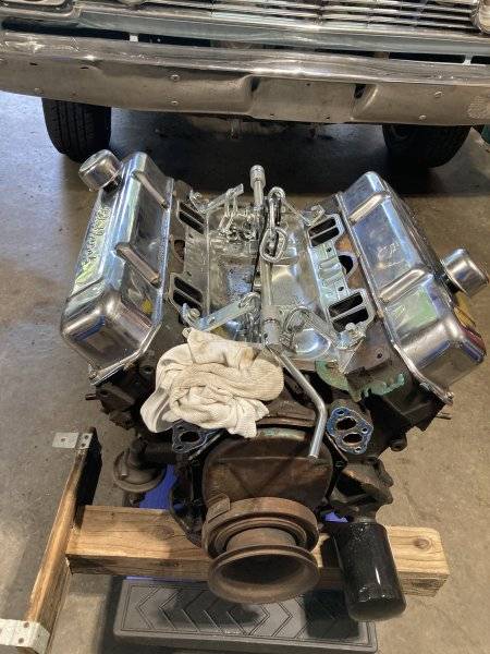

I stripped the three layers of paint off the intake manifold. The crappy blue paintjob had been done with nearly zero prep work, I could scrape most of it off the block and the heads with my finger nail. The intake took a bit more elbow grease, but we are almost there. Turns out someone had painted it silver at some point, I’m guessing to make it look like aluminum haha. My plan is to remove the oil pan and timing cover as well, allowing me to thoroughly clean, prep and paint everything outside of the car. Before you ask me why I didn’t just pull the whole motor, remember I decided to do this AFTER the heads were out at the shop, plus the car is parked on dirt and close to a fence where I can’t really get an engine crane to it. Even with all of that, I am 100% confident I can do 10x the paintjob it had before, and it is going to be proper Poly-red. Should look close to stock when I am done with it.

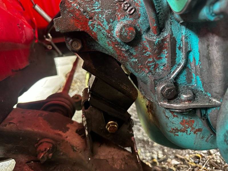

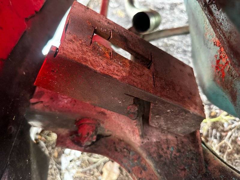

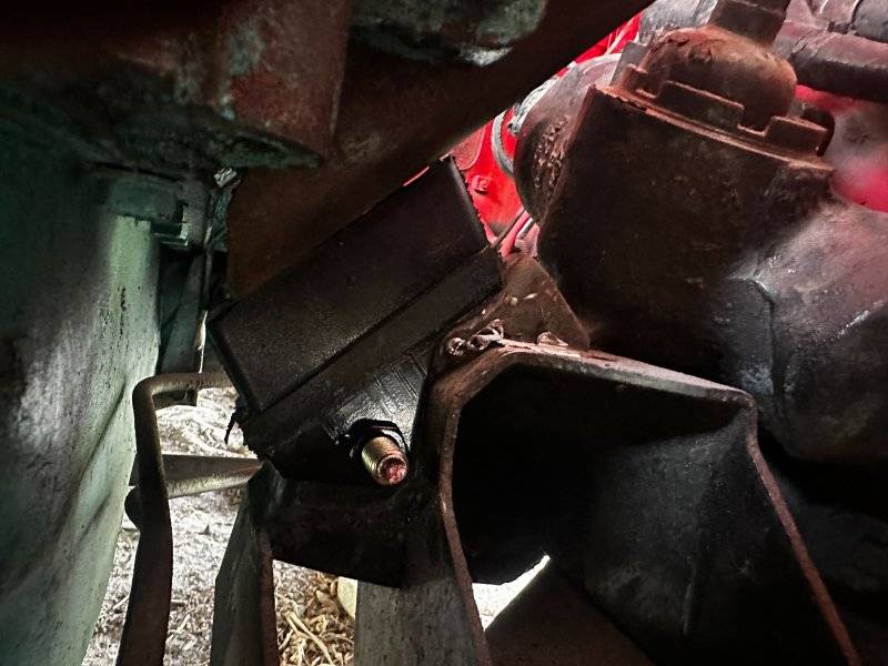

That leads to today’s discovery. I had bought new engine mounts as the motor moved quite a bit while idling. To my dismay, I discovered some lovely redneck engineering had been done to the motor mounts. So much for this being the “original numbers matching engine” to the car as the seller had claimed. The upper mounts on this engine were the same as my dads ’63 440 wagon, plus it has an AC crank pulley and a vacuum port designed for a brake booster. My car was not specced with AC or power brakes… Rather than just sourcing proper upper mounts, the guy… Well I will just show you…
Yep. He welded a piece of hacked up angle iron on the passenger side and used an old A body style mount he had laying around. On the drivers side, it was even funnier. He had actually bought the correct lower mount, but then proceeded to weld it directly to the crossmember higher up. I am all for redneck engineering, but for crying out loud, don’t turn around and try to sell it like it is an up-together original car! Just like the drivers side headlight motor that was “not working because of a broken wire”, which I discovered was actually just ENTIERLY MISSING! The headlight assembly was held in with bailing wire. Thankfully I purchased a couple of cores and will be having Topher rebuild them in the near future.

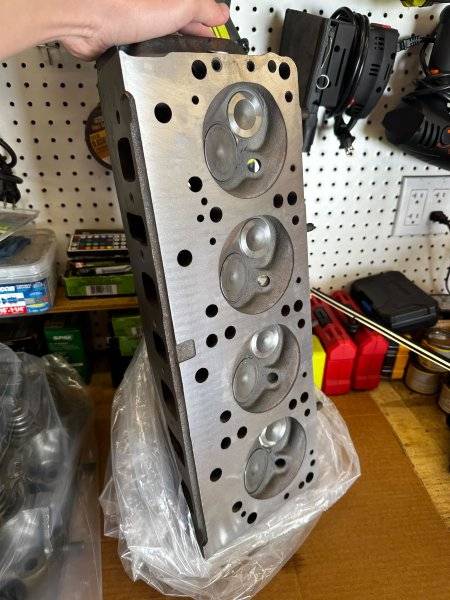

Small update, got word back from the machine shop about the heads. They needed a lot of help but are going to be very nice when they are done. 8 new valves, all new springs, knurling the guides, new valve stem seals, etc. Definitely a chunk of change but it will make this little poly quite nice. At this point that makes the entire top end essentially 100% like-new. Since I have gone that far, I am going to drop the pan and inspect the bearings.

First up, engine mounts. Through methodical grinding, I was able to remove the nonsense you saw in the previous post without damaging the factory mounts beneath. Some cleanup is still needed to smooth down the areas where welds were blobbed on, but I managed to do it without cutting into the factory metal! Now for pics of what 1966 Charger engine mounts are SUPPOSED to look like…

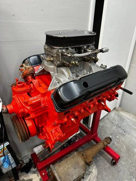

During this odyssey, my local machine shop was working on the cylinder heads. I got the post-inspection phone call and was met with “So I have good news and bad news…” The good news was that the heads were not cracked and were 100% serviceable. The bad news was that the poor things needed a lot of help. I already knew it needed a valve job, and had them lined up to knurl the guides, machine the seats, and install the new valve stem seals, but there was a bit more needed than that. Turns out, there were 8 valves burnt beyond repair, so those needed replaced. Also, the valve springs were VERY tired, and reading at less than half the closing force they should be providing. Possibly what bent those pushrods? I gave the greenlight to do the work, and man am I glad I did. I just got them back and they look fantastic!
The combination of the above two successes should fix every remaining issue I had with the engine, making this little poly nearly 100% serviced. I did a preliminary inspection of the bores and it looks like everything is still in good shape on that front. I will soon be inspecting the bearings as well. There was no noise, and the car had very good oil pressure, so I am optimistic that they are in decent shape too.
From there, she is getting a fresh coat of paint in Poly red, and will be looking very fresh very soon! I even picked up a factory style air cleaner from a fellow FBBO member that I will be refinishing. Once she is back together, she should look close to factory original with just a couple of small tweaks. I will probably paint the engine crossmember while I am in there as it will be the best access I get for a while. So much for not spending any money on this “little Poly”…
