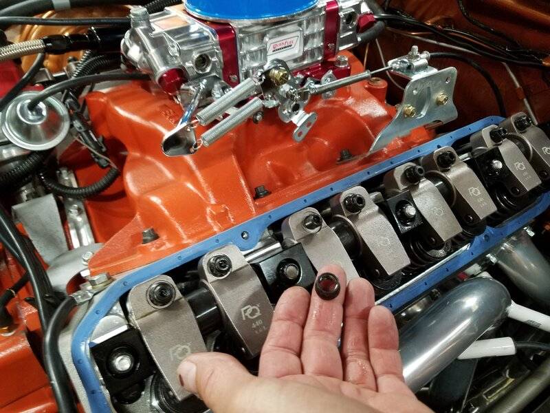

Messing around with the 400-493 stroker in my Super Bee. For those that remember, this is the second go around with this engine for me.
Built by a prominent shop in CA. The first one had a detonation issue. Pulled the motor and sent it back to get a milder cam, and dish pistons with a quench. I lost 20 hp and 4 ft lbs if I remember correctly.

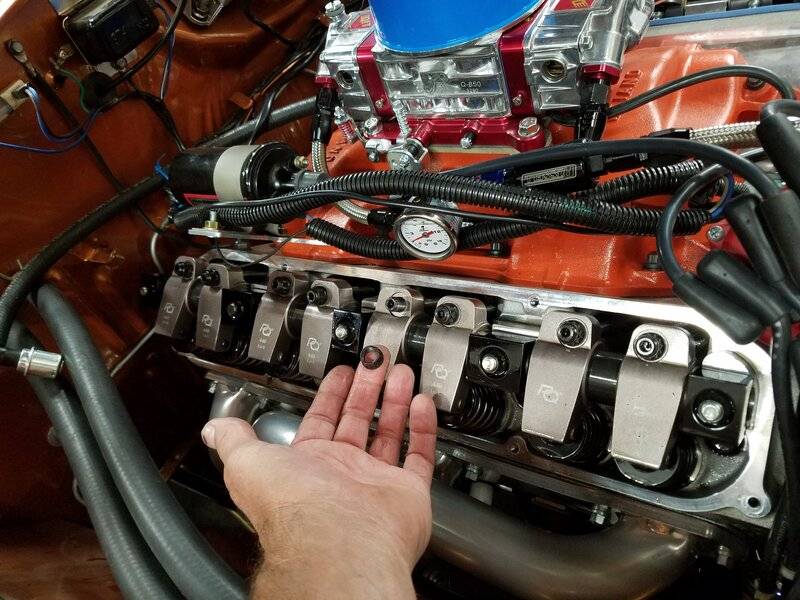

Anyway, got the new motor in last winter and have put 1800 miles on it so far. Have been noticing a progressively worsening valve train noise. Everyone says that hydraulic flat tappet never need service, so I just kept driving it. Today I pulled off the valve covers and was shocked to find the adjusting nuts for #3 intake and #4 exhaust laying in the bottom of the head. #1 and #4 intake nuts were loose. #3, #5, #6 exhaust nuts were loose. The remaining 9 are tight.
What could possibly cause this to happen?
PRW rockers, Trick Flow 240 heads.
Whoever adjusted them didn't tighten the locknut down tight enough.

mid be very, very pissed. That should not happen.
glad they were still in the head, 2nd engine they built for you and I dont think I would go back.
Especially after paying 15K to a top notch builder. Then having to pull the motor out of a fresh rotisserie rebuild, build a crate and send it back to CA, lose a summer of driving, reinstall, and have this surface. I'm hoping like hell nothing else was overlooked or any damage has been done driving it like this.
Good catch. Now take the time and adjust them your self.

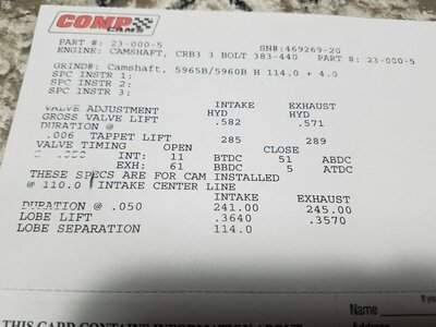

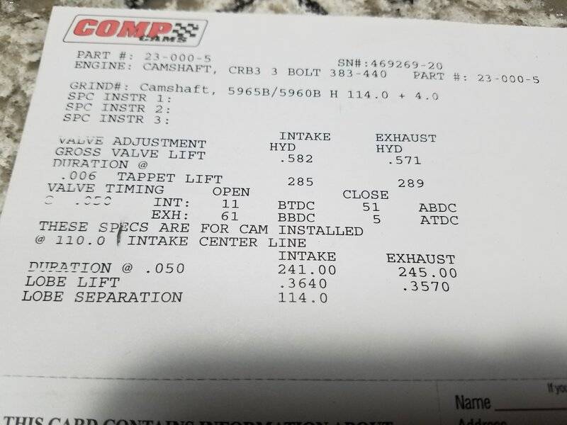

What cam and lifters? Reason I said 1 turn is that on a 3/8 fine screw one turn is about .040 preload. On my Hemi that was what was recommended. If you were closer I would swing by and help you.
I believe he said the lifters are Pro Top Line, which I have never heard of. He told me to go 3/4 turn past zero. I just need to find my notes as to where to have the motor sitting when adjusting which rocker.
I wonder if he meant comp pro magnums.. those are quite a different adjustment

Bummer! But, rocker adjustment really should be (in my somewhat paranoid opinion) checked every few/five hundred miles during the first couple thousand on a new build, just because things are still getting acquainted and wearing in. They sure *shouldn't* back off like that so soon, but it can happen. When folks say "hydraulics don't need service" they're meaning with a non-adjustable (stock) valvetrain.
If all the parts and pieces are accounted for, I'd say you dodged a bullet there by listening and being quick to respond to the strange noises...you might check the pushrods for bent-ness but if they're okay I'd bolt it back together tighty-tighty and run it.
Sorry to hear that a supposedly reputable builder made such a serious....oversight.
I'd be just as interested, (as you might be), to hear how much the PRW rockers were given for side clearance. I have a set on my heads, and thankfully I figured out early that the side clearances called for by PRW are WRONG. They ask for .0015-.0020. Should be .015-.020. Might want to look at that too. Good luck, and keep us posted.
