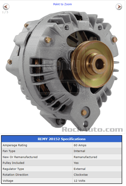

I've used a 60 Amp newer style alternator with dual fields from the 70's to mid 80's.
Take your pick from RockAuto or similar.

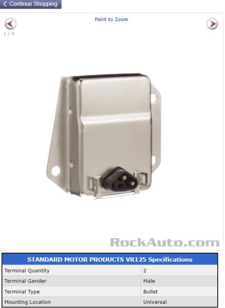

I also convert to a modern solid state regulator which requires running the extra field wire and a new plug.
I've bought newer style conversion engine harnesses for both cars which come with the correct plug and extra wire already in the harness.
This way you can replace with standard parts.
They work well for me it you really don't need a 100 amp alternator.
