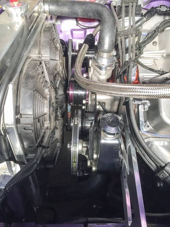

I have to modify my fan shroud a tad. The vac pump belt just a tad too close. Have a day off Monday. Hoping to get more done then.

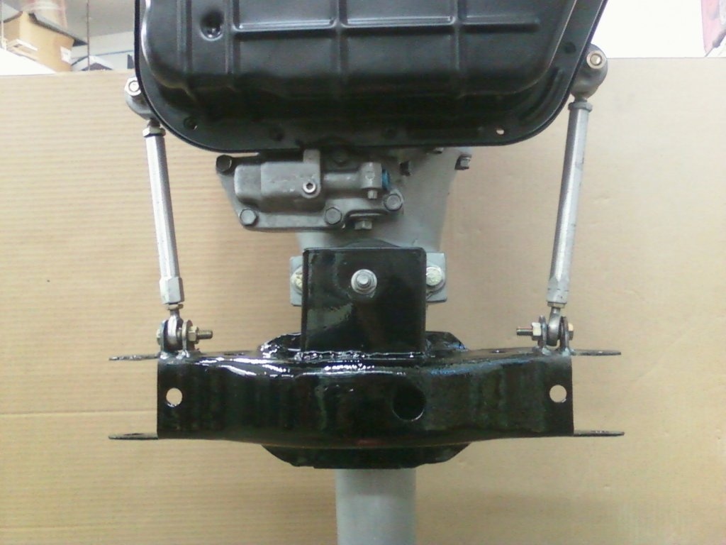

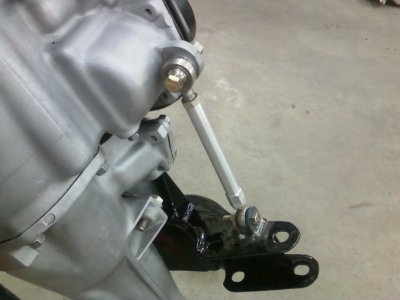

Doug, do you run anything to limit the for/aft movement of the engine besides the motor plate and trans mount?
Yes
Yes. Last car had K-frame tied to the loop on the right side of the block. This one hd the block lightened so i came up with another solution.
Doug
Patent Protected. Nice idea and work.

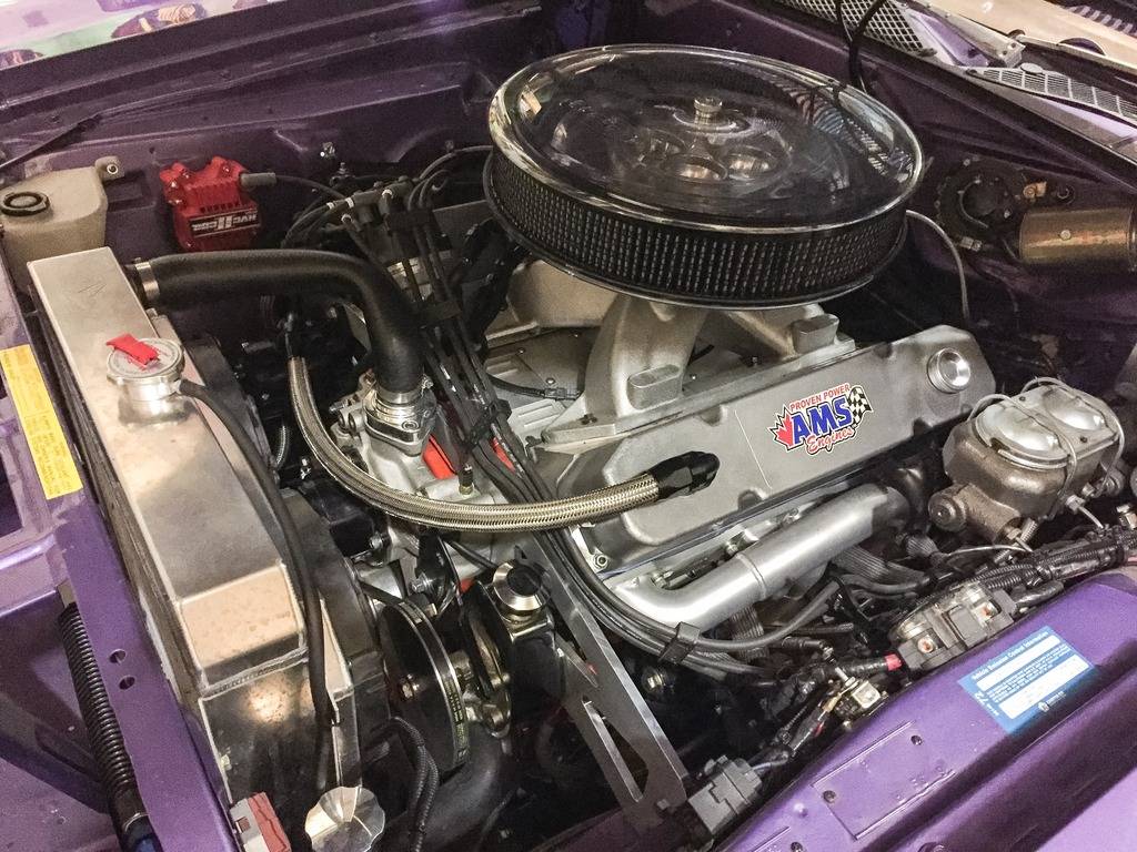

Had to narrow the fan shroud a 1/4" to clear mandrel. It is tight but should work perfect. P/S pump bracket worked out great so I could keep my hydro boost. Have only ran in the garage for a minute but cold vac is just over 5 at idle and 8 at 2000. I'm sure once it is warm it will be better yet. Need to wait for a warm day here now so I can back out of the garage. Quite happy how it came together.
