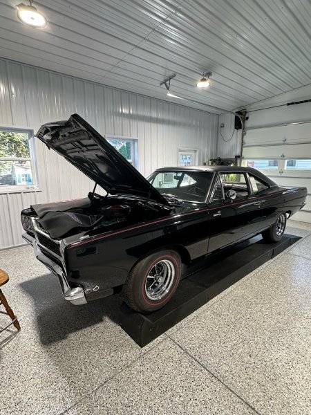

RM21 vin no Fender tag Have not found Broad cast sheet yet

Here's mine with no fender tag and I'm happy with it.
I replaced many panels and parts, so it is not original and quite a few car of this vintage have had body parts replaced.

Ps. Garage way to neat and clean. I’m jealous.

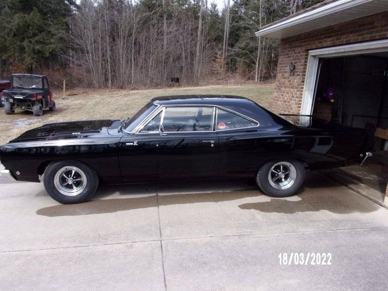

Congrats on the black cars; they're as sinister as it gets - and nice garage, BB34.
