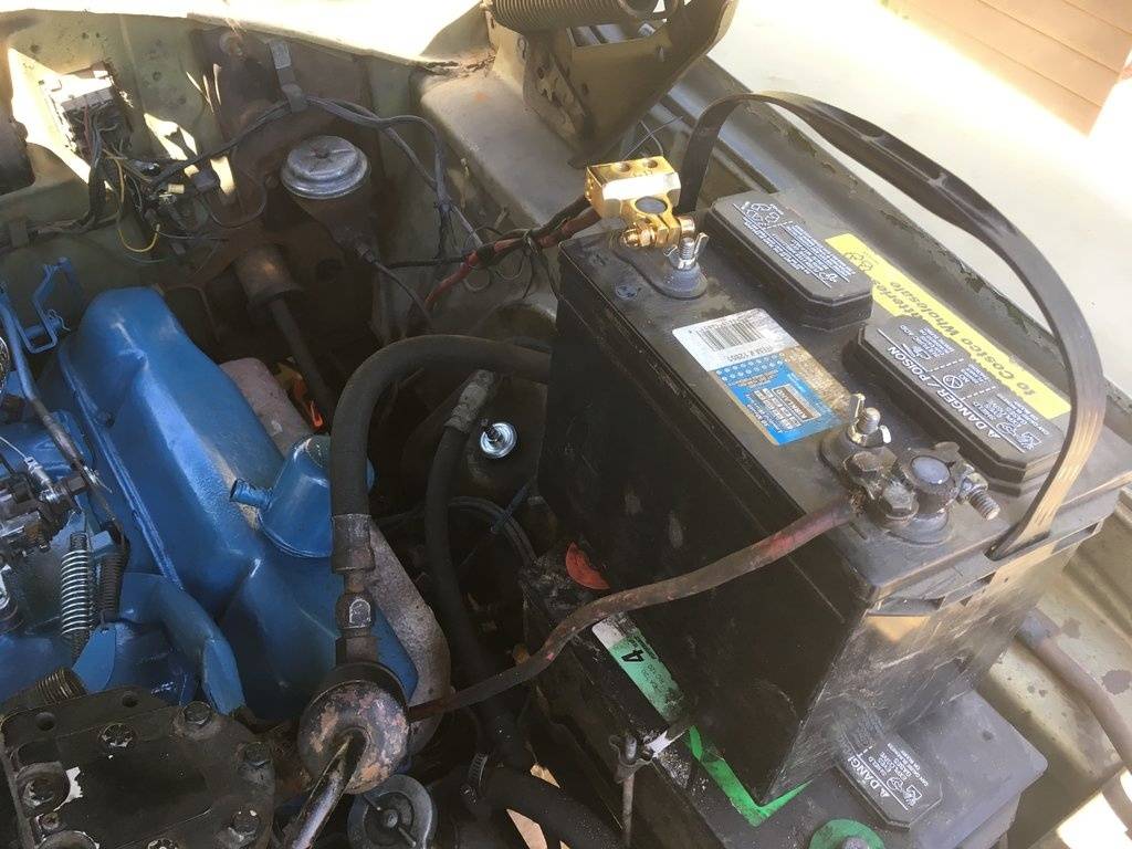

          grabbed the marine battery off my trailer it still stuttered a bit but fired up.. going to run to autoparts store get a new battery will keep you updated.. thanks again checking the starter like that is a real keeper.

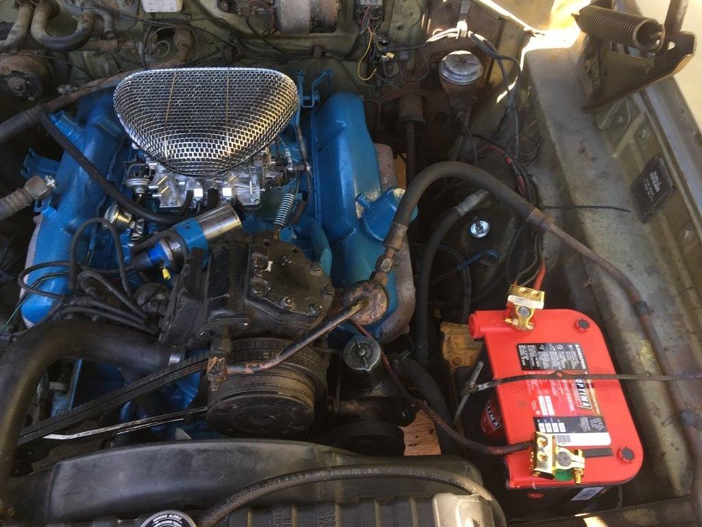

            Your Battery is dead!
            Tighten those alternator belts, they are about to fall off!
            Loose alternator belts won't charge your battery!
            14.5 or somewhere close should be what you want to see when it's running...

              you missed the first part of the post.. ive got the proper bracket in the mail.. the previous owner or mechanic fouled up the alternator bracket/tap on the head.. hopefully, that repair goes smooth.. will update the thread with the fix when i get the parts in.

              I'd also replace that ground cable, or at least get a good copper crimp style connector. Those replacement lead clamp on connectors can be a major source of resistance.

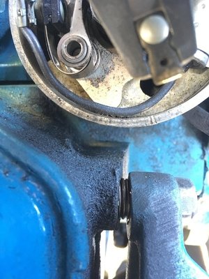

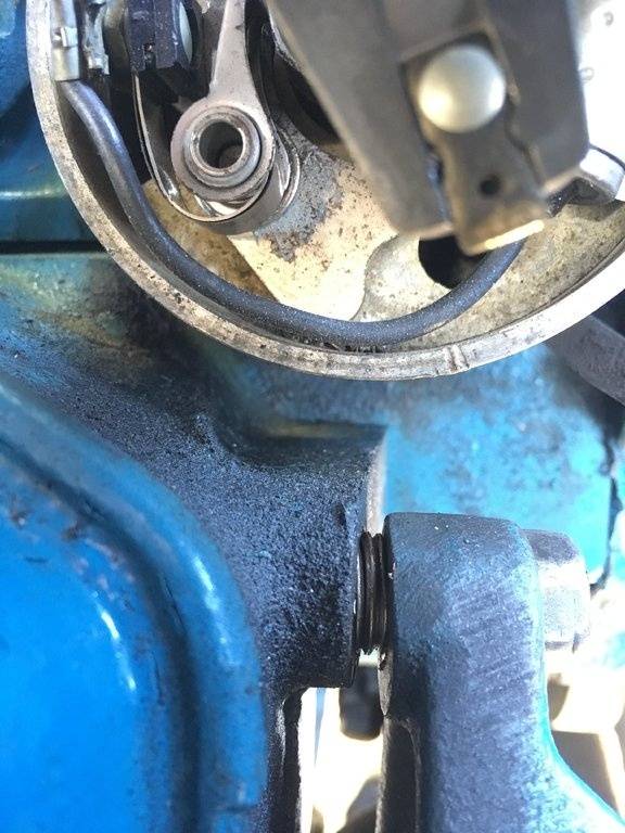

                onto the alternator bracket..

                  the battery was dead, in part due to the alternator bracket failure. I charged it, it still had low cranking amperage. Turns out none of the brackets i can find will work, also seems theres no way around using a the helicoil in order to get it installed without some machining. I have a call into a engine/transmission shop for cost on rebuild. Any ideas what that should run ? thanks again guys

                  It sounds like the bolt hole you're talking about just needs to be drilled and tapped to the proper size to install the proper helicoil. There are different helicoil sizes for different hole sizes to get you the proper thread size you need. I'm thinking a final thread size of 3/8" x 18 thread for the top bracket bolt.
