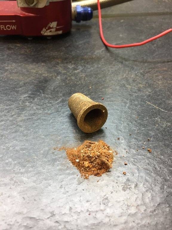

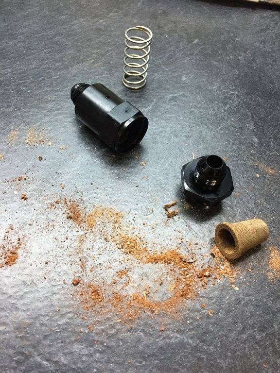

Removed the tank, filter and pump today. Had a look in the tank while I had the fuel neck out of it. I noticed on the sump some rust particals on the bottom, rest of the tank was clean. I then pulled my filter apart and woah.. Definitely a contributor to my problem. This filter was plumbed in before the pump.
Cannot understand how much rust there was. Car has always been in a controlled temperature, tank and sump both new..
A loaded filter. Explains the car always going flat on the big end. Amazing it went 10.87 @ 123 with this filter on Sunday.
The pump had to suck the fuel through that filter and then push it to the front.. Going with the new fuel cell will eliminate this problem. I'm betting that fuel gauge will sit at 7 lbs now and not flicker. Will be good to start being able to fine tune the 64 with this problem out of the way.

Looks like a too fine a filter element . Possibly too small as well .
I have a pleated stainless screen filter which also appears bigger ..
Those compacted filters are normally after pump not before .
Coarse filter between tank and pump , fine filter after pump before carb .

Thanks Tex. A proper 1000 micron will be going in front of the pump like you mention. I'll move this one on the outlet side of the pump. I installed this one based on a recommendation, bad choice.. I sure wasn't expecting to see the floor of that sump rusty like that.
On my Cuda, I use a 100 micron (mesh) before the pump and 10 micro (paper or cellulose) before the carb, as recommended by Aeromotive.
Thanks 65. Going with proper filtering and eliminating the source of the problem. Looking forward to having good constant fuel delivery!

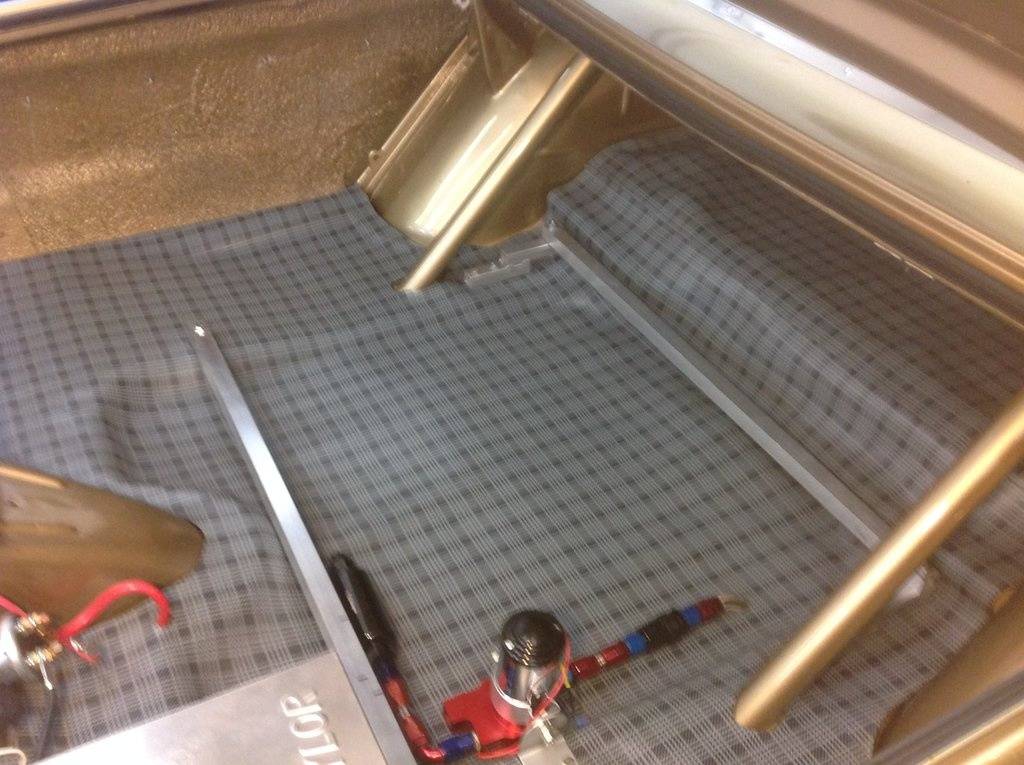

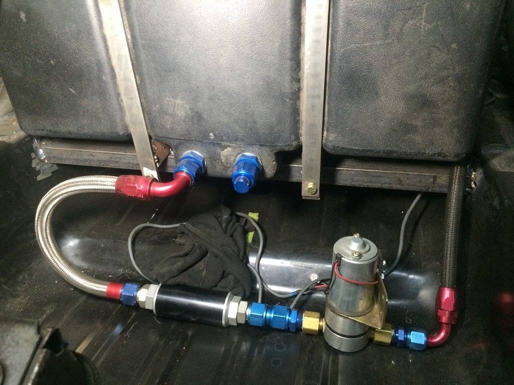

Got a good start on the fuel cell install today, except that the cell didn't show up. Tomorrow. Fuel filters and pump are relocated though and cell bracing in place.
Aluminum framework is in place, just need to run the strapping once the cell arrives.
1000 Micron filter before the pump and 30 Micron after. It's not a 10 Micron but it's here so it will do for now. Pump is also in place, wired and ready to go. Hope there's no rule about the mat...

Are you saying you did not reseal your tank after welding in sump ?
I know i did plus others have had to

The filter on mine is before the pump, 60 micron. This year after 400 passes I pulled the filter apart to check. Very little debris, no sand or rust. Aluminum fuel cell. Renegade fuel since new. Carbs are always spotless inside. Your filter is to small in my opinion. Mine is the size of the pump. -12 feed,-10 to the regulator,-6 to the carbs. Pump almost behind the tank.

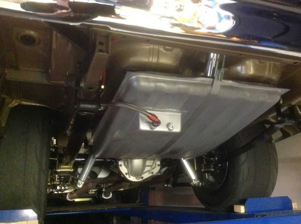

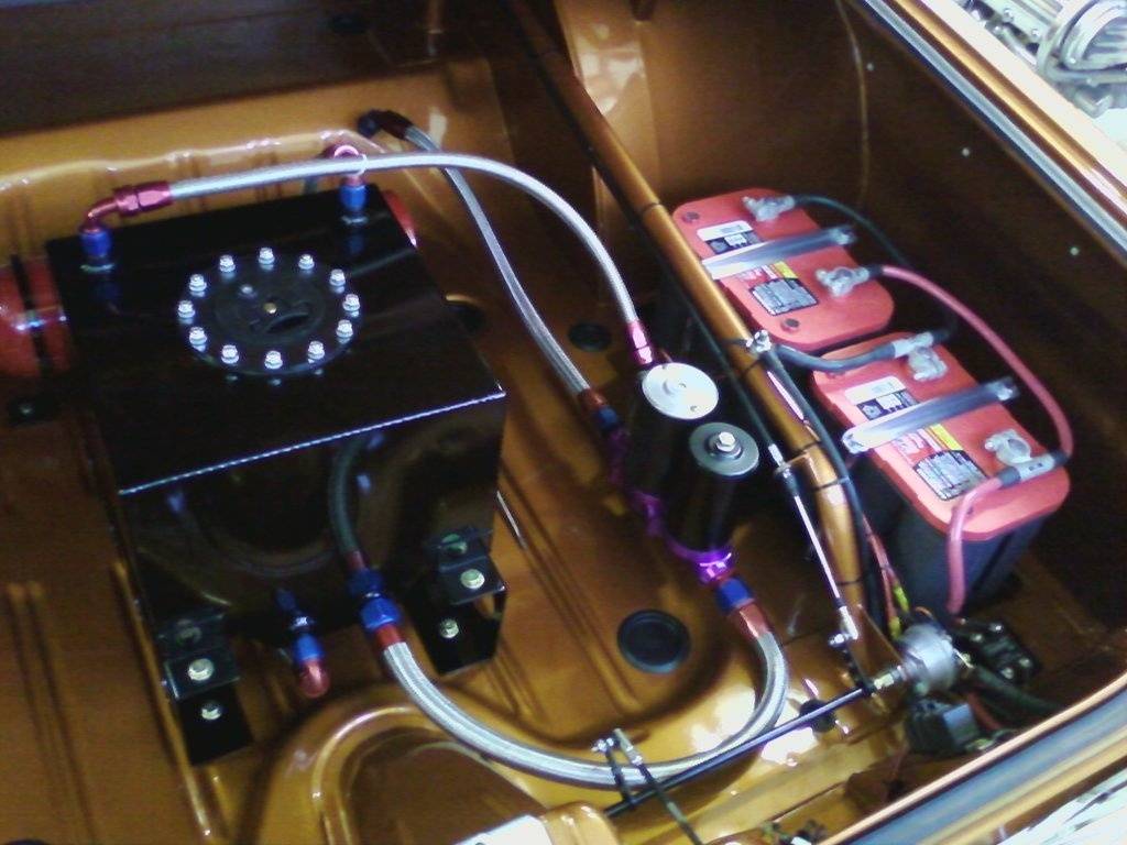

Here's how i did mine on my Coronet.
Street/Strip
11.20's-11.30's
Best sixty is 1.57
Average is 1.59-1.61
Overkill for a 505
But i'm gathering parts for a B1 540
Looks like you'll be flying with what you're doing!
Mike
