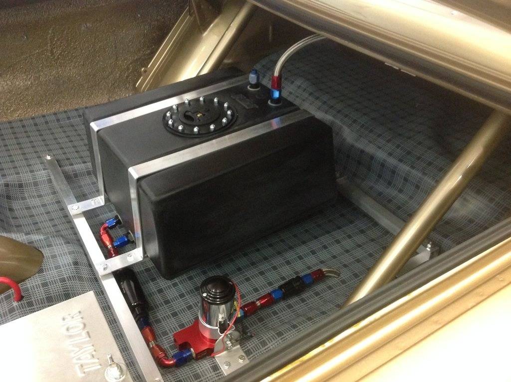

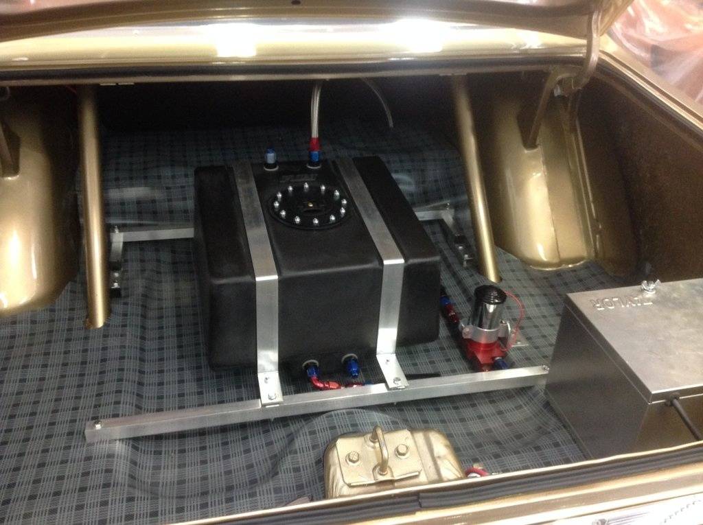

I think though that I was battling 2 problems. Aerating initially and even after running with more fuel, fuel starvation due to the filter being too small and plugging up. I previously had my pump 4' forward of the sump, and it was having to suck the fuel forwards through that small plugged filter. Now I have a coarse filter prior to the pump and the pump is lower than the sump and behind the cell. I'm not sure that I've ever had a proper source of fuel at any point so far. We'll know once the 64 is back up to the track.
And the RCI 8 gallon fuel cell is in and ready to go.

A distant friend of mine runs a 63 with a 528 Hemi and at one time he was using the stock tank and sump. Eventually he switched over to a cell. He said that he would see irrational fuel pressure too. He sumed it up saying that: "I tried to have a street car and a race car together you soon find out its one or the other .." With the fuel cell I'm pretty confident that there won't be any more fuel problems.

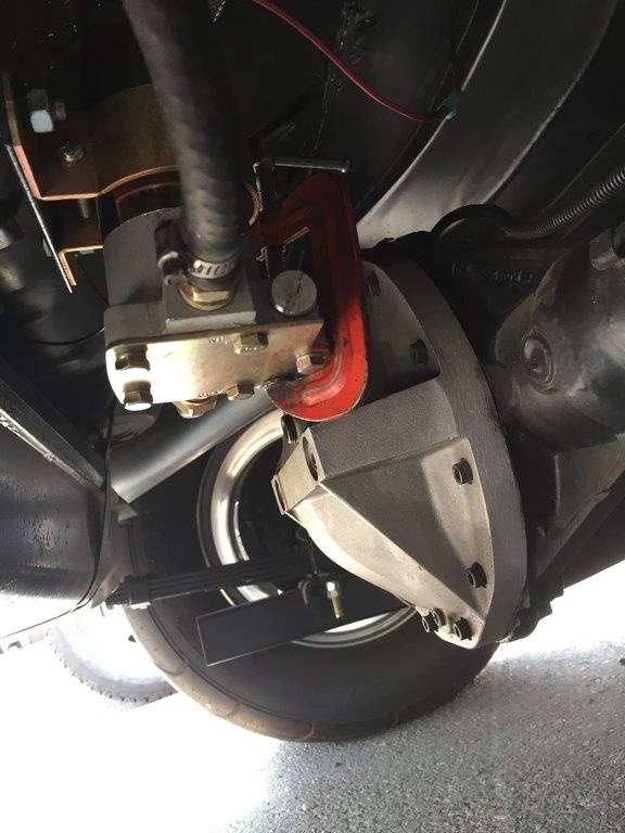

Speaking of a Holley pump, mine started leaking on my other car today. The gasket at the bottom on the corner, had to do a quick fix and not another drop afterwards.
Check it out.
