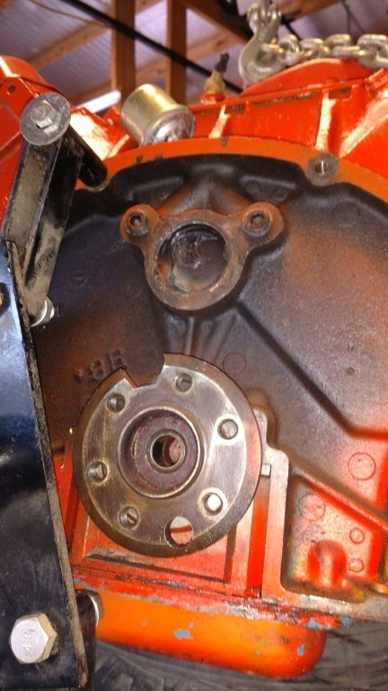

You mentioned it was a 73?
Take a peek at the pilot bushing? Does it look thinner than a normal one?
Was/is it new?
I have a "secret stash" of the old thinner ones if you need one.
Lots of threads here how to measure depth too.

Standard OD is .940
These are OD .915
Old NAPA 615-1033- discontinued

Who cares? Run the roller bearing in the torque converter pilot, easy.
Doug
Doug
Yeah, that's what I was referring to as the "Ehrenberg" one - Rick sells those roller ones just for that.

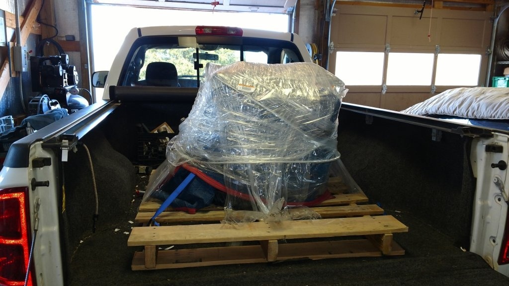

Well gentlemen...it has arrived. Looks to have survived shipping really well. I'm pleased, the seller did a hell of a job packaging it. I see no signs of damage at all, not even a hint that anything was leaking either.
I snatched that thang off the truck and got it on my supposed 1000 lb. capacity engine stand by myself, so that's all she wrote for me for a day or two, whilst having the flu no less.
Whew.
I figure this probably is the last time I'll go through all this, so the heck with caution.

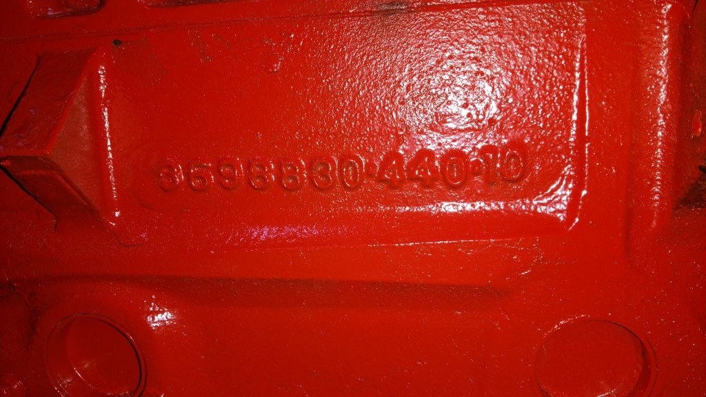

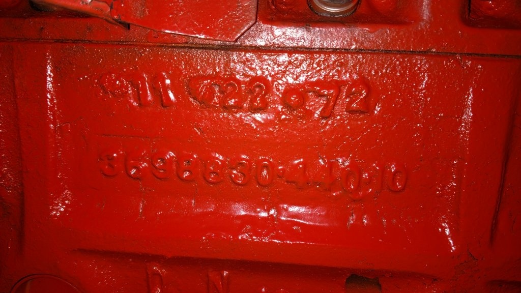

Now, the questions start:

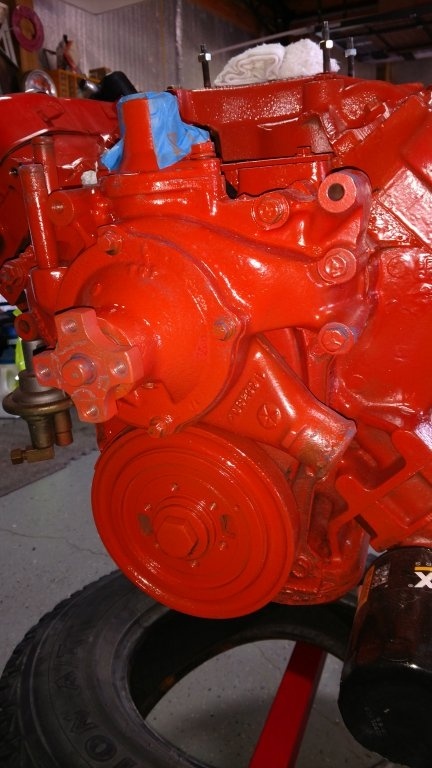

1. Is that a forged crank I see? I see it's been tapped for a 4 speed and has a bronze bushing in it already, but I expected that since his was a 4 speed also.
2. Is that a "correct" balancer for the crank or do I need to swap on the new one I have from Summit (it's their silver "house brand" one for forged cranks).
3. How would a '73 motor wind up with a steel crank, if it is one?

The damper on there looks like it's for a forged crank. They are about 1" wide. A 73 block could have been re built with a forged crank. I did my 77 that way. And I think the truck motors had forged cranks. Most of the R/V cranks were cast iron, I believe. They weren't built for high RPM, just low end torque. And yes, I would start a new thread for this new motor, so as not to confuse this one with the old mystery motor. Good luck! I'm anxiously waiting for the latest developments!
