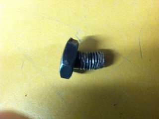

I broke all the torque converter bolts saturday on my 68 coronet. Good news it went 10.94 @120. Why on earth are the bolts only a 5/16? A stock 150 hp small block chevy used a bigger bolt than a 5/16!
Is it possible to drill out the holes in the converter and flex plate and re tap for a bigger bolt? What do you guys use? The trans is and flex plate are fine and the bolts that were in there were not ARP's but were hardened. Any suggestions? Trans is coming out this week. Thanks
Not a clean break, almost looked to be loose I guess. I know I cranked em down good though. You think its possible to drill and tap for a 7/16?

How 'bout some pictures of the broken bolts!What about the holes in the flexplate,are they elongated?

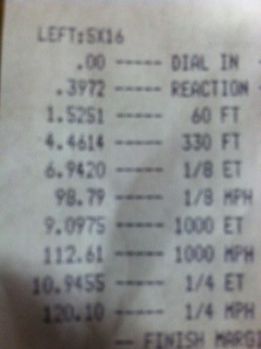

Gotta work on reaction and heat the tires a little more but not too bad for the first time out, minus the converter issue. 10.94 time slip.JPG

I know, they're like 10 bucks my problem is the threads in the converter are beat up bad.
I'd say buy anther converter and not from the guy at this converter shop because I think hes full of ****..the bolts from what I'm looking at were hitting the block.make sure you use converter bolts with loctite.I have never had a converter come lose.just saying....is this a stock converter going that fast?..........Artie
