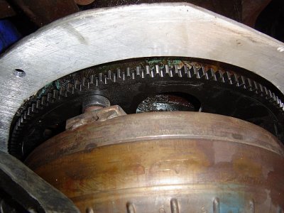

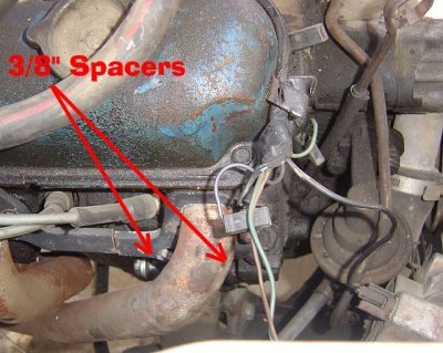

I originally wanted an ultrabell conversion for the 700R4 which would be as compact as possible to give more room compared to using an adapter. No such luck. As far as I could tell, an ultrabell conversion doesn't exist for Mopar-700R4. :icon_sad: So I purchased an adapter that uses a 1/4" plate with 3/8" spacers on the torque converter and a spacer on the starter as well. It also came with the custom flywheel & hub necessary for the conversion.

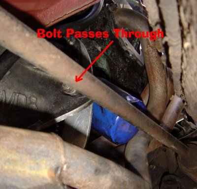

I was able to ream out the transmission mounting hole for the lowest bolt on the right side next to the oil filter to allow one 7/16" bolt that goes through both the trans and motor to hopefully give the adapter a little more strength.
The 700R4 gets big where the tailshaft mounts to the end of the transmission. Beyond this point, the transmission won't fit through the stock T-bar mount in the tunnel. With the added length of the 1/4" adapter plate, it became necessary to move the motor/transmission assembly forward 3/8" (an extra 1/8" for more clearance) to keep the tailshaft mount ahead of the T-bar mount.

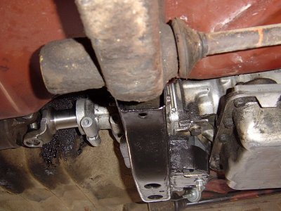

Also, I was able to use the STOCK driveline from the 904! That came as a welcome surprise. I just purchased an extra length transmission yoke for the 700R4 from Fastshafts and used a 7260-1310 conversion u-joint to mount it. If you get a yoke that is too long, you can cut the end of it to the exact length that you need. That is what I did.
You can also see in this picture how close the upper portion of the tailshaft mount gets to the T-bar tunnel.

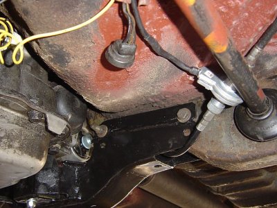

There is a round governor on the right front of the transmission that required a small dent in the floorpan to clear it, but it really didn't need much of a dent to make it work well.
The cable exits through the bottom of the T-bar tunnel in a location that already had a smaller hole from the factory. Routing the cable required a 3/4" hole in both locations.

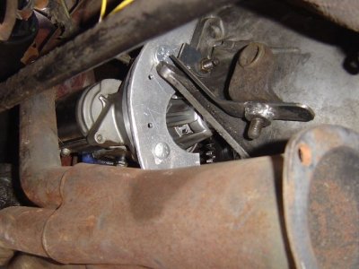

I also chose to automatically engage the lockup on the 700R4 at 42mph with a speed sensor from B&M that attaches to the speedometer cable. You can see it in this picture. It includes a control box up top that allows you to overide it and adjust the lockup speed. My only complaint with it is they didn't provide a good way to mount the thing. I will probably put some good quality foam between it and the T-bar and strap it to it.
The cable routing looks worse that it actually is. There are some bends in the cable but they are not too sharp to cause a problem. I still haven't figured out what to do about the backup lights and neutral safety switch. As far as I know, GM put them in the shifter, but I may just bypass the neutral safety switch and live without the backup lights for the time being.
