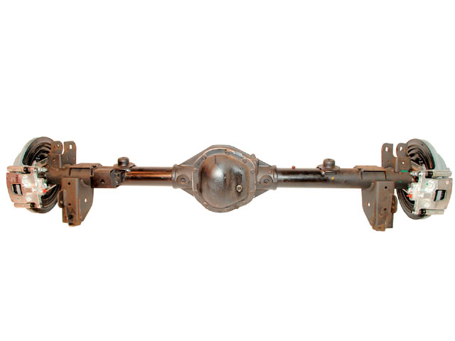

Here is the Dana 44. SLAM different than the 9 1/4.
The only reason people don't like the 9 1/4 is because they simply don't know. No way in hell would I swap an 8 3/4 for a 9 1/4 that I already had. No way. No how. You yank that 9 1/4 out and send it to me.
