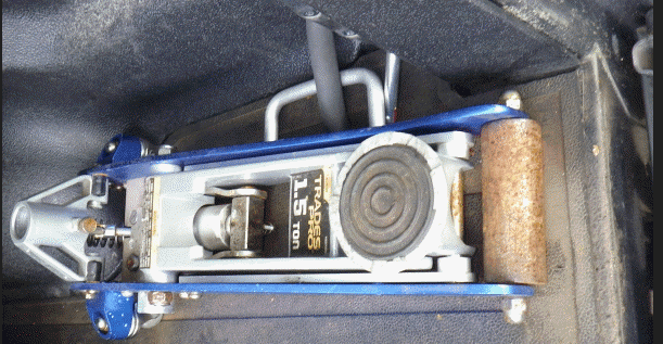

I bring my old 35 buck (clearance) aluminum Walmart floor jack along and a battery impact JIC such occasions occur these days.
