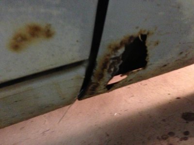

Started my project today.
Had planned on driver door skin, both quarters, both rockers, and rear front fender.
Found out after tearing it apart it needs new trunk pan and the full quarters not the short skins so already $750 over budget and it is the first day.
DAY 1

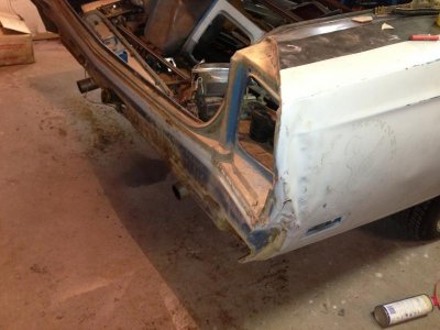

WEEK 2
Cutting off passenger quarter, quarter off, took off front fender to fix the dent in it and... weld new rear lower fender panel
Now I found that I need a new trunk pan and after wire brushing floor pan found too many holes around the dimmer swicth so will need a left side front floor pan too. Gonna leave the shift tunnel on and cut around it this time.

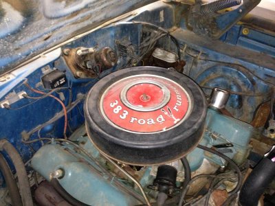

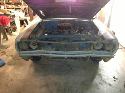

Pulling the engine
Engine out, turquoise is going to be orange!!
pretty much everything is stripped but the dash board and window above
Passenger side all done waiting for primer
Now we start on Drivers side
Start pulling the engine apart to clean and paint
It was rebuilt a while back and only has 500 miles on it, but sat 6 years, so new gaskets since I have it out anyway
