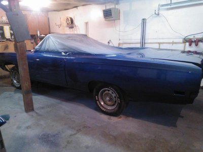

1969 drop top bird resto
wow some one has been busy looking good keep at :headbang:
Engine out, turquoise is going to be orange!!
read the last post first and when i read Engine out, turquoise is going to be orange!! i thought you were saying you were painting a turquoise car orange...and i was thinking NOOOOOOOOOOOOOOOOOOOOO !!!! then i'm like ... that car looks B5! what is he talking about ??? LOL, then i got it :)
Looking forward to this resto!
B7

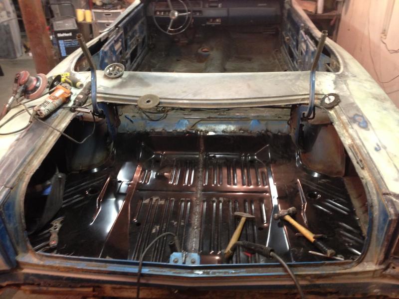

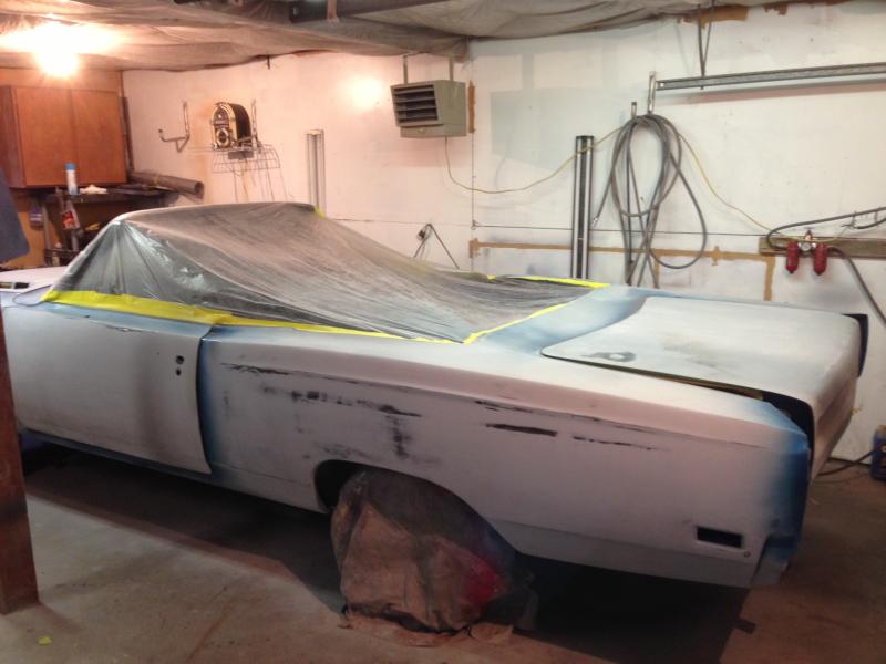

new trunk pan
primered

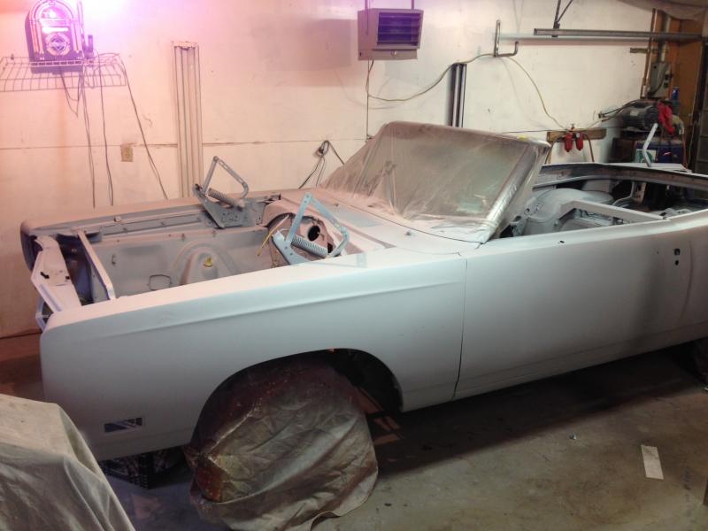

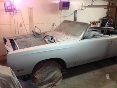

door jambs, engine compartment and trunk sprayed and final sanding

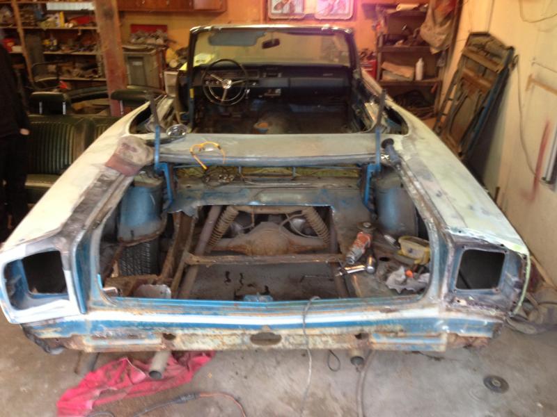

Wow - you are not messing around. Did you end up having to change the rockers like you mentioned previously? If so you guys have to be the fastest guns in the west.
yes new rockers, WOW lots and I mean lots of pin welds, like every inch

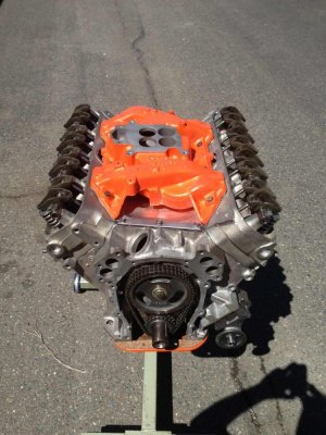

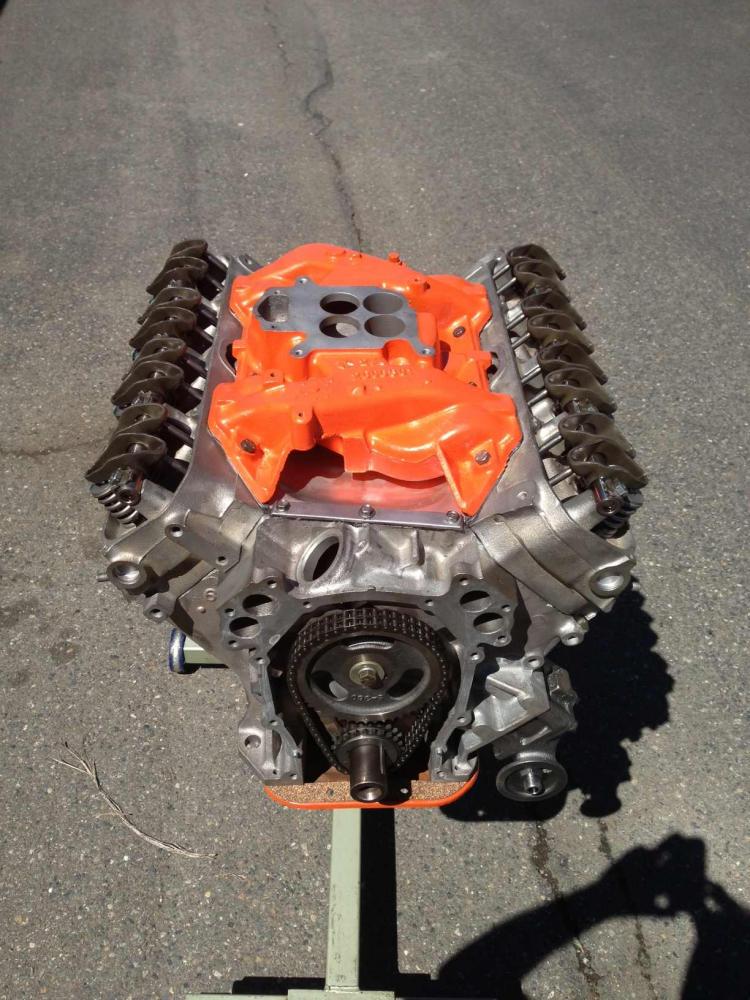

Got teh engine back from the machine shop
YEA!!!

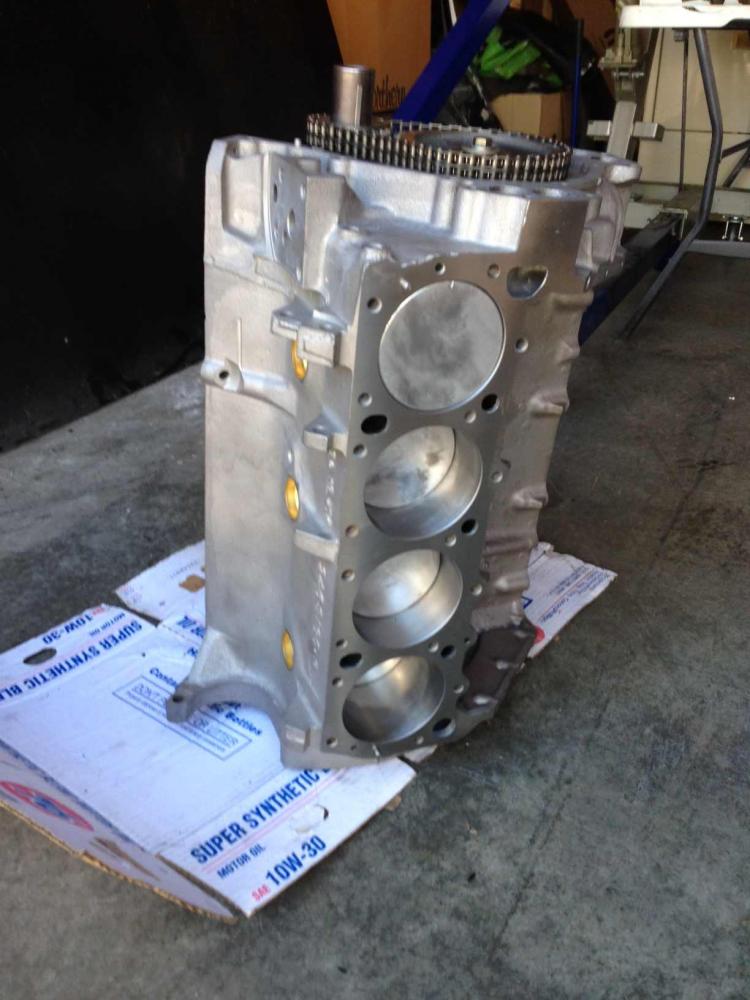

Starting to put it together, lost mt garage space so it is difficult to work on now, had to rent a storage unit for now LOL
FINALLY got the -5 timing chain from Cloyes. Now I can finish engine, soon as engine is in it is DRIVABLE!!!! I can do teh interior over the next few months.
Yes changed rockers too!!
Looks great so far.
Just one word of advice you will need the oilpan loose to get the timing cover on properly.
Timing cover should have been installed prior to oilpan.
yea the oil pan only has 3 bolts in it to hold it on and keep the gasket from getting torn laying around the storage locker.
