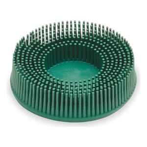

The 3M Bristle disc's work awesome........But, pricey.

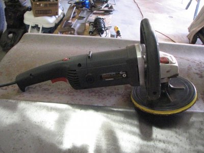

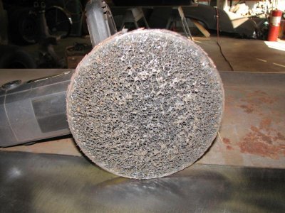

Get a Harbor Frieght Polisher / Sander (on sale for 29.99) and a 3M paint remover disk (7" diameter) 18.99 at Fastenal. Do not get the hook and look 3M pad because the Harbor Frieght Sander comes with one. It will probably take 2 or 3 disks to strip the whole car. You can also get small 3" pads for a 90 degree die grinder. See pictures below.
Link to 3M disk. http://www.fastenal.com/web/products/detail.ex?sku=0819170
