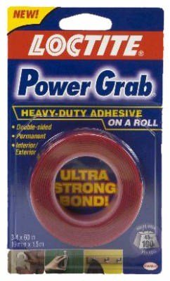

ooouuu...Tough one Mar. Reminds me of how ma mopar used that same technique to secure the inner vent window frames to the chrome outer frame.....crush pins. My suggestion would be A) leave it on, work around it. B) Take a Dremel or a die grinder, shave the crush pins flush from the backside so the emblem comes out. Work the pins flush to the emblem and use a really decent two sided tape like Loctite's to secure back on. Use a razor to trim the unwanted excess tape around the emblem.
Good luck.
