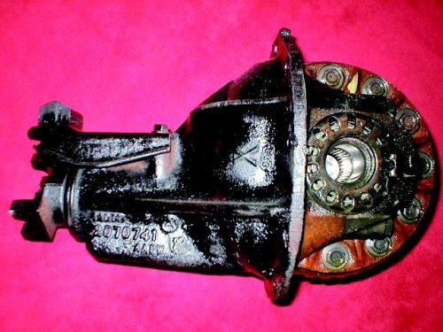

as far as ID'ing the carriers...
You can tell by looking at the center section, on the driver's side you'll see the casting numbers like on this one:
Last 3 digits say what it is, this is a 741, as you can see (a 489 will also have a big 9 cast in it where the X is on the 741)
