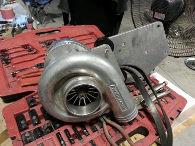

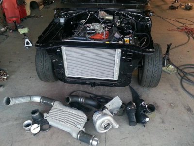

Thanks for the replies guys, and yeah from what pictures I could find of mopars running prochargers the drive belt did look to be piggybacked onto the existing crank pulley, the main one I wasn't sure about retaining was power steering but I'm sure whoever I buy the mounting stuff from will have some info on that.

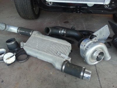

And true the intercooler should help, especially since I only plan on running 6-8 psi, so maybe a heat shield will be enough. The car will see a lot of driving and I'm sure rain at some point so fenderwell is out of the question but we'll see when the time comes I guess.
And not sure about the details just yet herr, just heard that it was pulled off a 5.3l chevy and now for sale, waiting to hear how much the guy wants for everything. But I haven't heard a bad word about their reliability ? I personally know a guy that's running one on his daily driven el camino and loves it. And their facebook just shared a guy that has had one on his corvette for 205,000 miles with no maintenance but regular oil changes.

I know it should, that's why I said I couldn't go wrong haha. The inducer roughly measures 3.5" so it should be good. It shows its age with a little surface rust on the compressor but there's no shaft play or chunks taken out of any fins or anything, and all in all looks like a pretty good unit. Worst case scenario I send it in to be rebuilt, I'm still heaps of money ahead of buying a brand new one. $250 bought me the head unit, pulleys, mounting bracket (for chevy), procharger intercooler (6"x18"x3" core), autometer phantom af gauge, fuel pressure gauge, bov, and all the piping.

Yep the end goal is a procharged 440 with full sequential efi following what this guy has already put down as a really successful setup:
http://www.dodgecharger.com/forum/index.php/topic,99432.0.html
But I'm not looking for huge power, just a shot in the arm of my engine that will be semi-daily driven. So I'll most likely start out with a pair of the larger chamber edelbrock rpm heads, Flatout head spacer gaskets, a boost friendly cam swap, possibly a drop-in msd dizzy, 20 psi 100 gph electric fuel pump, aeromotive boost referenced regulator (I'm only planning on running 6-8 psi), and the blow through holley double pumper I'm currently building. Bottom end is already forged, balanced, and still practically brand new. Won't be a 1,000 hp roadburner but should give me everything I need to get a decent, reliable tune. :shruggy:

Surprisingly no but it was definitely a steal I made on it haha. And thanks for the heads up, I'll keep that in mind. Depending how expensive the 440 mounting brackets are and how much mine is worth, I might just modify this one but we'll see

They sell the brackets only for the procharger on the 440 at summitracing. You download the procharger PDF file for the install and it has a parts list that has a parts number for just the brackets and hardware and then call summit they will sell it to you. I have done this with many many vortech setups and 5.0 mustangs
Oh that's awesome thanks for the info, would you happen to have any links to the pdf download? I'm looking around but not having much luck. My procharger is a P1SC if that matters
