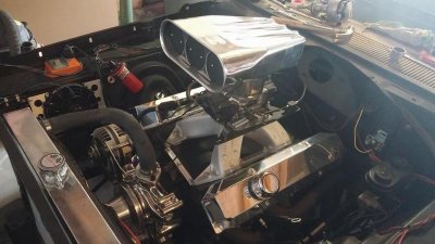

well,with no choke you may have to feather it a bit to keep it idling on its own.how big is the cam and what is your idle speed set at?i have no choke,huge cam,and strait through intake.takes a couple tries to idle on its own.open plenum intakes are very cold blooded,depending on your set up. 10411292_237489503112653_6391885681296785854_n.jpg

at about 60 degrees outside it is very cold blooded.starts after about 3 pumps of pedal,but need to feather it for about a minute or so.then need to let it warm up for a good 3 to 4 minutes or will try to stall when i hit the gas.alot depends on how big the cam is.i have advanced about 20 degrees initial time because the cam is so big.
