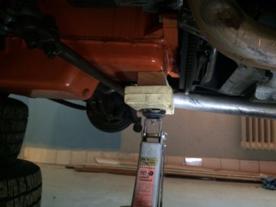

First time removing the trans I need some help,
This is my general plan: I tilt the engine/trans package down I bit, then support the back of the engine,
then try to pull the trans out with a floor-jack.
The thing I´m worried about is, when I pull the trans backwards the angel to the engine changes, because the whole thing is tilted..(and the floor-jack isn´t)
and the "front axl" of the trans gets stuck in the clutch assembly...
Sure this has been done many times before, so how do you guys do this?

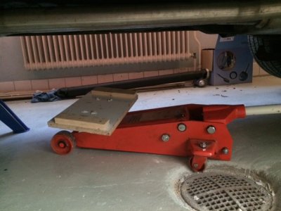

yepp i´ll try to avoid that, I've made a "board" attached to the jack to try and balance it!, se the pic above..

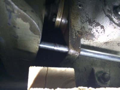

So I've made some progress since last time, the guide pins worked perfect!
The trans smoothly slided down the pins, until it stopped!:icon_mad:

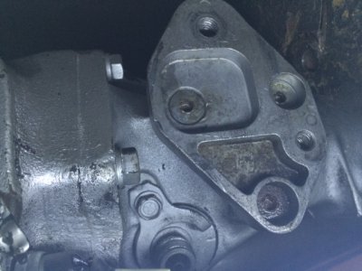

The mounting plate of the gearshift had stopped it! Had to be removed,
Now to the problem, the mounting plate is attached with three hex key bolts with Very,very round insides!
My first attempt will be to try and remove the bolts with some sort of special toll, broker screw remover etc..if all that fails I will try and cut the damn thing of with a
saber saw! what do you think of that good, bad other ideas are welcome.
Chances are those bolts holding the shifter plate will be loctited in place. Be careful using heat from a blow torch - maybe aim the flame directly into the hex entry on each bolt to maybe loosen the glue. :eek: A soft hammer (Copper/Hide) might be useful to tap the block around some.
yes i´ll keep that in mind if I use heat, might bee a good idea..I´m afraid that the Hex is to far gone to be screwed out with a allenkey,
I´ve got a tips for using a little to big Torx and hammer in place, might try that..
/Linus
Oil pan resting on the drag link? Might need to drop it.
Shorten those pins and round the off the ends. 2" will allow the input shaft clear the crank flange and spline from the disc I believe.
Looks like someone failed to get the bolts out of the adapter before. May have to drill the heads off.
