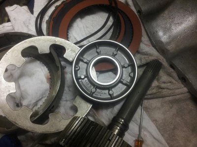

I found a picture in my phone but it is before I installed discs. What happened was all discs totaly burned out,belleville cracked, plastic sealer in pieces and a thin (extra?)snapring in pieces was found at the bottom of case. Maybe the "extra" snapring was used as a spacer and also a very bad idea?
Go back to the Moparts post I attached. You will find the 2 springs do not look the same. My bet is the replacement spring you used is the different than the original. Early spring (73 earlier) is used with early piston, Late spring (74 later) with late piston. The last 2 digits of the year the piston was cast will be on the piston.

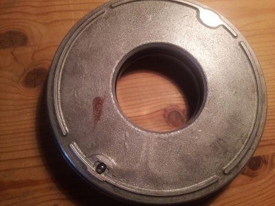

I have about 0.078. Piston is marked 72 and I have early style belleville. I don´t understand why they doesn´t match up better, could it be I have a later retainer?

I can see some scratches on the "backside" of piston, could it be to thin? (It is 19.9 mm, that would be about 0.78 inch.)Min piston.jpg
I've never had a failure with the stock piston. We currently run 3 cars over 600 hp with them, in fact 2 have well over 800 hp. If the stack up is correct put it together.
