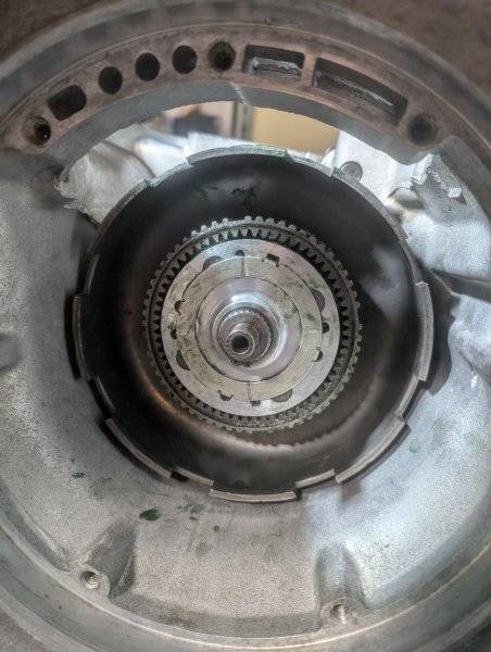

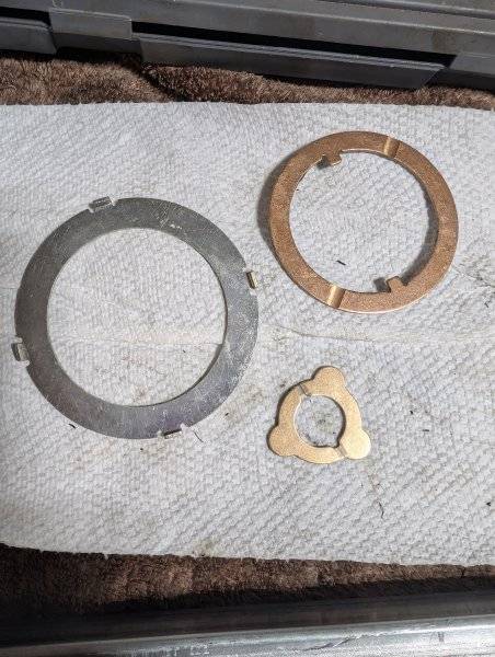

So what's the most obvious thing to look at as I disassemble it? It seems to me there is a lot of movent in the clutch packs s as I can see the part inside move (pic). I have a 3 thrust washers left over (pic) and they are all ~ .062 thick. I replaced all but the one under the sun gear snap ring (the book didn't seem to rebuild the sun gear) - but maybe I missed it.

I have rebuilt a lot of 727's, but do not recognize the thrust washer at the 2 o'clock position in your picture. If you can get the snap ring on the output shaft, with about .010" clearance, the rear stack-up is O. K. What are your front and rear clutch pack clearances. I suspect that you might have left out the .086" phenolic washer under the oil pump. With that back in, your endplay would be around . 013" .
I'll double check, but fairly sure I put a non metal thrust washer on the back side of it. Seems to me it was closer to .062
The small washer with 3 tans started up in the late 70's. The back of the rear clutch is clearances for this. Did that washer fit in your trans?
What year is your trans! a 1970?
Dod you put a small washer on the end of the output shaft before you put the clutch packs in?
Factory was dark brown fiber, aftermarket sells a bronze one with oiling slots. Either is fine.

I had another one in that position if your talking about on the end of the output shaft. The pic is where I'm talking about - I think I used the original washer there as I didn't have an exact match on the rebuild kit. You're saying that 3 tabs small one goes there?

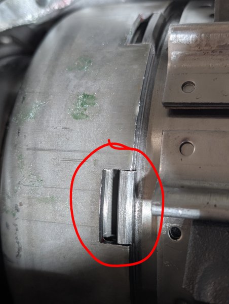

Post #1. Clutch pressure plate does not look fully seated. One clutch plate not engaged?
That's with the input shaft pulled out as far as it can. It goes back and feels fully seated, but clearly it shouldn't move that much.
Good you have a washer there.
Yes the 3 tab washer goes there in a late 70's trans, it won't fit your 1970.

Something is wrong there. That is NOT fully engaged, and the sun shell will wear if run like that.
