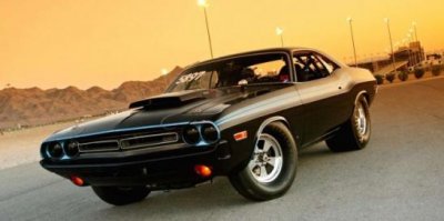

Agreed Big Hemi. The person that wants both height and narrow width is limited when it comes to front radial tires. I'm not sure what tire is on this Challenger but the full fender well sure looks good. image.jpg
What they don't make 215/75/15's anymore.... If you can find them there pretty close too 28in tall.
