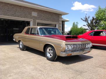

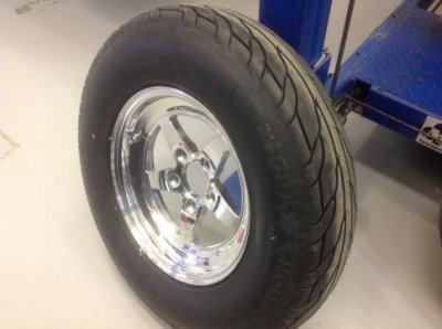

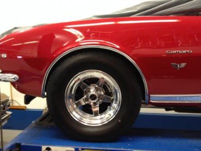

I have the Mickey Thompson 28 X 7.50 SR radials on both my Plymouth and Camaro. Probably exactly what you want. Check it out. image.jpgimage.jpgimage.jpg

That's what I bought, except in 26", and ran them for two days at the start of DragWeek 2014. I put the steelies and street tires back on which I've ran since. I will be selling them along with my Centerline REV series wheels they're mounted on.

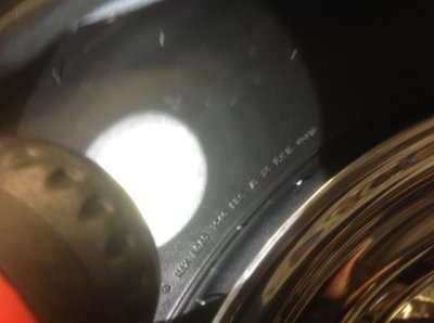

I took a picture of the rating for you. M/T SR Radial. 28 X 7.50. image.jpg.
1040 lbs, 35 PSI. I sure didn't have much luck in finding a tall narrow tire, I always ended up back to the SR. The Sportsman Pro steered like crap on the street, very unpredictable. The SR's on the 64 steers like a dream.

The SR's solve that problem. Their is no difference in the heights between SRs and the Pros, but the SRs have a more squared edge. On my Camaro the Pros fit nice with no rubbing when turning. The SRs though, the outer squared edge will take you closer to fender lips on the front and rear when turning. I had to do some non-visual adjustments on my Camaro to make them work.
I couldn't find any other radial tire other than the SR that filled the wheel opening and was narrow enough to fit the 4" rim. I like the old nostalgic hot rodded look you'd see on these cars back 40+ years ago. The 4" fronts are part of that.

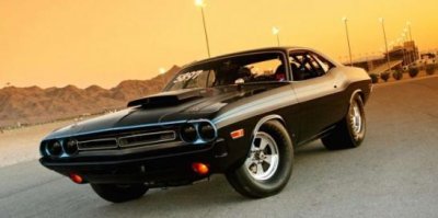

Agreed Big Hemi. The person that wants both height and narrow width is limited when it comes to front radial tires. I'm not sure what tire is on this Challenger but the full fender well sure looks good. image.jpg
