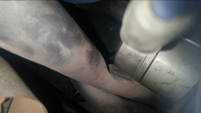

So I had Headman headers installed on my 1973 Dodge Charger SE with Flowmaster super 44's a while back at a reputable exhaust place.I installed a mini starter before hand and noticed the battery and solenoid connections were towards the engine block instead of like the oem starter.I didn't think much of it because it matched up just fine.When I picked up the car the installer was standing behind the manager and told me the starter on your car is the wrong one I said why is that you say he said I had a real hard time getting the headers in there.I said well that seems odd considering it's a lot smaller than the stock one.So 6 weeks go by and I'm working in the engine compartment and I look down at the starter and the ceramic coating was disclosed it wasn't black any more. I look farther down and that idiot smashed in the tube to get it to fit I was pissed.So today I went in and talked and showed the same manger what he did and he said that's not right so they will discuss it with the higher ups on how they want to fix this problem.
The reason I went with the mini starter in the first place was of the issues in the past with full size starters 33 years ago I had with these cars.So now I have a dilemma do I just get a new stock starter not a remanafactured or find a mini starter that has the battery and solenoid connector on the left hand side instead of the right hand side if your sitting in the car. I purchased a heat sheild to help with this issue but I haven't installed it yet because of the issue at hand. Any direction or help is greatly appreciated.
Thank you
Doug

View attachment 342714 View attachment 342715
looking at the picture, I don't see how a stock style starter would fit either. I have Hedmans, and the only way they will fit is with a mini starter. The installer should have stopped at the point where he had to bring out the hammer, and asked you what you wanted to do.

I did do research 33 years worth of it I burned up 2 starters in 3 years back in the early 80's with the exact same car. My brother in law has restored 3 dodge chargers 1 challenger and just finished a 440 cuda he was the one that suggested the mini vs stock starter. I've been around the block a time or to with these cars.

I have Hedmans on mine as well ('68 GTX 440 4-speed). I wish I didn't (previous owner installed them). The fit is awful with these and spark plug access absolutely sucks.
I too don't see how a stock starter would even work with Hedmans. I have a much smaller 1995 Dakota V8 starter on mine and the headers hit on it the same place as on yours - it's as if Hedman refuses to acknowledge these things HAVE starters or something.
