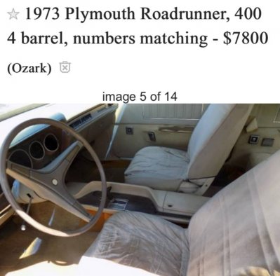

Here is picture showing the FOUR power window buttons on the 73 Roadrunner driver door mentioned by YY1 earlier..... The seller states that it it a RM21 car.
Transplanted p/w doors?
I've got a pair to go on mine but will swap guts because they're Charger doors.

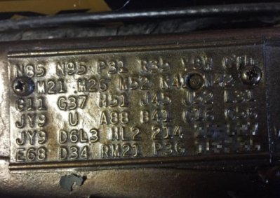

Looks like the fender tag is missing on that car.
Can't see the rear panels too clearly, but there is something odd you can see on the driver's side just above where the switch would be.
Someone should ask for pics of the back panels.
I don't see evidence of the doors being swapped, but that's kinda difficult to ascertain.

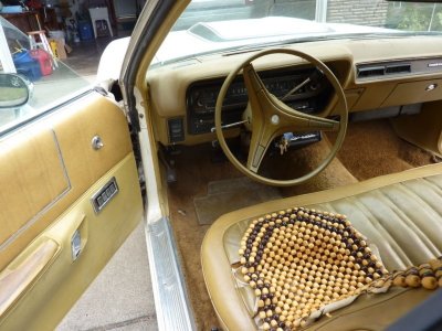

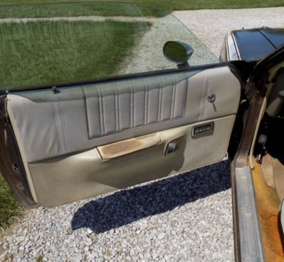

These two photos are from a recent eBay auction of a 73 roadrunner that had factory power windows. Notice that the driver's door had the same four buttons and also notice that the picture that shows the passenger side of vehicle shows a single button on the front AND rear panel!! The "P31" on the fender tag confirms its a real power window car...
View attachment 347657 View attachment 347660
Busted.
I was gonna say a dash swap is pretty easy.
Both cars maybe.
