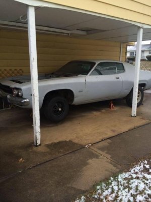

Hello everyone this is my first build ever. Bought the car back in highschool just had issues with making money but now I've started buying parts. The car was originally a 73 satellite with a 318. I'm trying to clone it into a rr and I'm dropping a 383 from a 68 rr in(I know not periodically correct) just looking for help and advice from other people who are currently trying to do the same thing or have already cloned there car any help is much appreciated

I'm from mercer county I'm about 10-15min outside of Trenton. You're car looks awesome. This is my car she's just a roller now just waiting for the time to work on it. I'm in the marines and stationed in nc so I don't get a lot of time to touch just mostly buying parts for now
