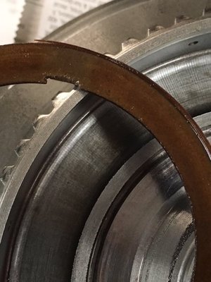

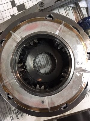

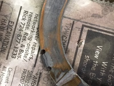

Here are the thrust washers. Like a dummy I didn't check the input shaft play before I took it apart. (I didn't know there was any issues with the trans.) I was just going to swap out the drum and put it back together 40 passes on this this Trans. I do the transmission so I'm not sure what the guy did. Any ideas on what would cause this?
The upper picture looks like it has wear on the edge. Is that correct? If so I'd be looking at interference where it sets against the annulus gear. Being that is a 5 pin planet it is not the factory original part. The 2nd pic isnt that abnomal either. It looks like that thrust washer was actually behind the stator support previously and got switched, same part. The 3rd pic is normal. There is only thin babbit on top of the copper. Never seen a unblueprinted 727 that didn't have enough end play. How does the reaction shaft/pump thrust washer look?

The fiber in the pan was from the fiber washer between the two drums which is shown in the second picture. The wear is really bad I know the picture doesn't show that.
The first washer is only worn on the out side edge. The 5 pinion planetary was purchased from A&A in 2011 so it isn't that old. I can feel a little ridge on it.. I'm just trying to figure out where it come from.
With this all being said the fluid looked great red as can be with no metal in it... and that is with an aluminum drum.
The fiber washer on the reaction shaft looks mint. no wear at all.
Thanks
What overall endplay did you have? Id run a stone over the thrust washer surface of the planet to make sure it doesn't have a high spot. The 5 pin thust washer should be the same outer diameter as a 3 or 4 pin. Take a good look at the front drum surface for burrs as well. I'm assuming it wore the phenolic resin washer on the drum side? Call Rick at A&A, he would know better than anyone. You don't suppose the internal splines on the turbine side of the converter could be buggered up forcing the input shaft rearward? I run an A&A aluminum drum as well, no such issue. It has very little endplay, .010"-.015".

Ok, tell me if I'm doing this right or not. checking end play I would put the indicator on the input shaft and them push on the output shaft while pulling on the input.... trying to take up any slack in the assy. doing it that way I'm getting .025
How are you checking end play?
Yes it's the resin washer between the clutch's. Now I mic'ed the old washer and it was about .080, so I put the thin one from the A&A thrust washer kit.
Thanks again Doug.
Thanks again Doug.
By the way, what 2nd gear band lever are you using, 4.2?
That is how I do it. I've used 5.0 and 4.2. Now it's down to a 3.8. My theory is the lighter the rotating assembly is the less ratio it needs. Mine has an aluminum drum and a milled sun shell.

I got the Trans pretty much done tonight. (thanks for your input, it was a big help!)
