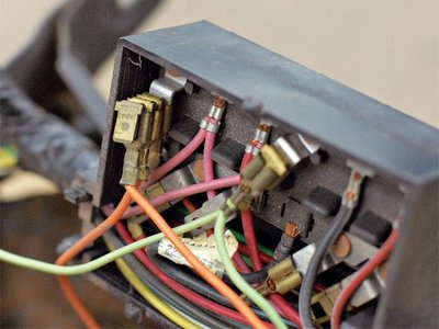

See if you have a multi terminal on the fuse box with pink wires going to it. If so take one spade off of that terminal and see if that gets you anywhere. By the schematic its the 3rd fuse from the left. You can see 3 pink wires coming off of it. Which feeds the windshield wiper switch, stop light switch and the headlight switch. Taking the plug loose at the wiper switch would also be a way to narrow it down to either lighting or the wiper being the issue. Since you have all three fed from the same fuse it has to be one of the 3 causing the issue.
In the picture below are the terminals Im talking about. There should be pink wires 3 of them piggy backing off one terminal like the others in the left side of the picture. Take one pink wire off at a time and see if it changes your outcome. This picture has orange ones piggy backing but the pink ones should do the same.
Actually this one is better. Look at the pink wires in the 3rd terminal from the right in this case . They show them here piggy backing. That is the place to remove one and test again.

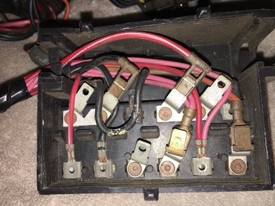

Here is the back of mine. It has a few pink as it has the light package...
I was going to pull the fuses to 2 and 3 and trace back to look for any open to ground.
