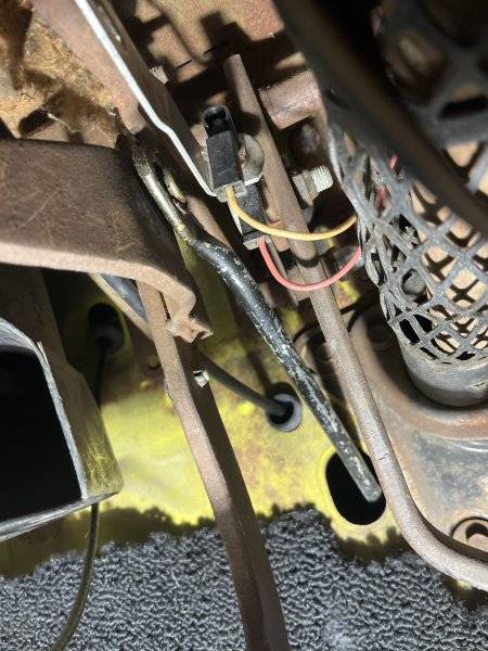

My issue is under the dash, see picture. To test the switch, use a multi meter, put one probe to ground and the other to the out put wire, on my car it is white.

Guys, I’m good to go. I don’t know how it worked itself loose, but the white wire worked it’s way off the switch to the point it was no longer making contact. Visually still on though. Sorry I missed that first time around, but thanks for all the help. I lucked out today!!!
