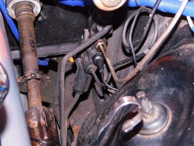

This is what I call a distribution block. It has a switch to tell front or rear brakes
aren't working.

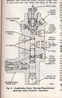

As you can see from Mike67's picture a prop valve is much more complex than dist block.
