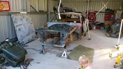

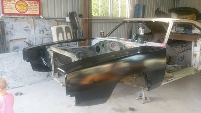

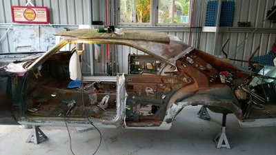

bit of an update, got the car 99% stripped, only rust i have found was a couple of pin holes in the lower rear window frame, happy days.
got my 4 new fenders, slow progress, but really enjoying myself again.
IMAG1004-20170824-165643821.jpg IMAG1003-20170824-165644918.jpg received_10214665533901022-20170824-165643467.jpeg received_10214665535981074-20170824-165643218.jpeg
Couple of updated pics, time to start the body work over the next couple of weeks, looking for tips on replacing rear quarters please.
I am a boilermaker by trade but have never worked with such thin gauge metal, any tips appreciated.

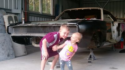

my new amd front quarters, rear quarters, drivers door post and front valance has turned up, woohoo and my beautiful kids posing and getting ready to help, i hope haha
IMAG1072-20170912-220229192.jpg IMAG1065-20170912-220229977.jpg IMAG1064-20170912-22023170.jpg

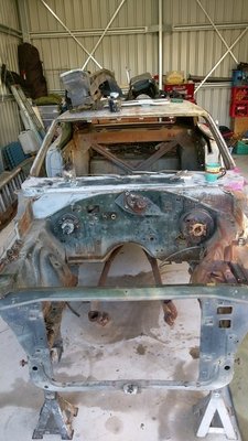

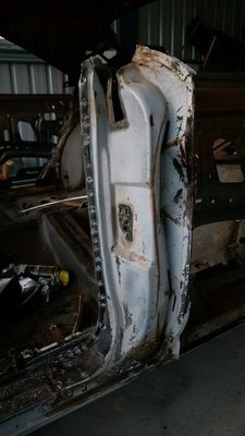

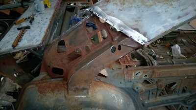

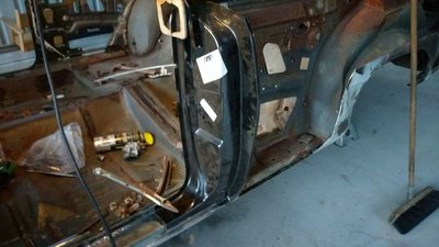

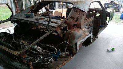

Made some progress today, got most of the rear quarters off, first one was a pain in the ***, but getting there, and got my new door jamb clamped on.
anyone know how to get rid of all the surface rust on the inner panels and inside the roof as i dont think a wire wheel will get into those tight spots?
IMAG1084-20170916-175014517.jpg IMAG1089-20170916-175010268.jpg IMAG1092-20170916-175009416.jpg IMAG1082-20170916-17501668.jpg IMAG1086-20170916-175012925.jpg
I always use 2", 3" and heavy duty scotch-brite type sanding disks on a 90 degree hand grinder along with wire wheels in the crevices on the same grinder. I also use a sand blaster if need. To me, cleaning that stuff up is the absolute worst / least fun part of the restoration.
Another way, but it pretty expensive, is to have it chemically stripped and then E-coated. The company that does it in my area charges about $3,000 for the shell. I have more time than money so I always opt for my first solution.
Also, a buddy of mine mentioned to me a dustless blasting company that can strip it using just high pressured water. He told me for $200 he'd show up and strip the whole car in my driveway and it would only take him a few hours. For the price, I'm going to give him a shot when I restore my next one. After he's done I will still have to scuff everything with 80 grit for adhesion prior to applying Epoxy Primer.
It is at this stage of the build that most guys will brace the car up and send it out to be media blasted. Unless you detach the roof skin you will never get all of the rust out of the top side of the inner roof structure or for that matter the bottom side of the roof skin. Unless it is comprimised there is no real reason to re skin the roof. Also anytime the original sheet metal is in good shape I would try to keep it. While the repro sheet metal is very nice I found that it is much softer than the stuff Chrysler used. I had a hell of a time trying to beat out even small dents in the old sheet metal while just leaning on the door to buff my car out left an impression in the new door skins.

roof is okay, should i remove roof skin to get in all under there? or only get to the places i can get to you reckon?

thanks, i would prefer to clean it all up myself instead of blasting and there is no company in reasonable distance that can dip it.
also should i be spraying rust kill or equivalent on the metal after wirebrushing or just primer?
roof is okay, should i remove roof skin to get in all under there? or only get to the places i can get to you reckon?[/QUOTE
Removing the roof is really unnecessary. The little bit of surface rust between the skin and the support structure that has accumulated over the last 50 years should not cause you any issues. It is mainly surface rust . Nothing structural. The only time you should remove the roof skin would be if it is visibly weak and compromised.

what do you think i should do to get rid of that surface rust in between the roof and structure?
