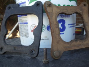

After looking over my parts stash, I found this '68 340 manifold with Carter AVS did have the 1/8" insulator (not saying it was factory installed) with 1 1/4" bolts with "TR" on the head of the bolt. These bolts I have then should work OK. (ThermoQuad insulator on left, AVS insulator on right in foto)
