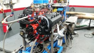

Good Luck. Lets hear the results. Always a fun day. Mine from when we dyno'd it.
We didnt make a full pull because i had a cast iron flywheel for the dyno.
The motor will go to 7500 rpm.
At 6900 it was at 730 hp and still pulling.
I just ordered a carb spacer for it and will make another pull once that gets there.
They say maybe 760? But who knows.
It also made 631 tq. which I was very happy with.
For comparison, the old motor made 678@7200 and 564 @ 5300
I was hoping for 725 hp 600 tq.
No rear seal leak either lol
Please give us a quick recap of your motor build. thanks.
.030 440, stock block 1/2 filled, BCR aluminum caps, arp studs, 13:1 comp .280@.050 .680 comp roller, 1.6 harland sharp rockers ,indy cnc295, indy intake ,1050 dominator.
