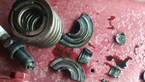

I'm going to need a set of retainers and I don't want to go through this again. Can titanium retainers work on the street and is there a life expectancy on a steel retainer or any type retainer for that matter? These were 10 degree heavy duty supposedly. I bought the heads from RHS which turned out to be indy years ago and I only know that because I bought the open chamber heads for my step head pistons and received the closed chamber heads and had to ship them back. I have 13,000 miles on the engine and just want to know what type of retainer will go more than 20,000 miles with a 587 lift cam. Am I dreaming? Rant over, thanks for any input on brands or part #' that will help. 11/32 stems with single groove valve tips. Thanks in advance for any help you can give. Ken
First Question did the body of the rocker arm hit the retainers? Must know this before you do any thing. Second Question where is the the rocker tip striking the valve tip. What is the Installed height of spring vs recommendation of Vendor..
As far as the rocker arm hitting the retainer I didn't see anything during my preliminary inspection but I will be taking the shafts to work to clean and inspect. And I added the lash caps to help correct the rocker arm geometry which I'm aware of as being important to longevity. And as far as the proper spring and their setting I relied on the seller who did ask about what cam I planed on using to take care of that. Even if I had them rechecked like most say to do I would still have to rely on someone else's work which is hard to do with my background as a ASE certified mechanic for 25 years and a Master mechanic for 15 years. The lack of specialized equipment causes us to sometimes have to rely on others for their expertise. So without getting more off track in this post I will be checking out everything I can. Maybe it was a freak thing and I'm just looking for better options to prevent another failure all other things considered. I look to the members here for their expertise and advise. That's why I like and rely on FBBO, many more people with more knowlede than I have in these things. Thanks for your input everyone.

Look close at the bottom of the rockers and see if you have any contact with retainers. Also how is the tip striking the valve seem??
Do you mean how the rocker sweeps across the valve tip. I checked to be sure the rocker stayed the same distance from center thru the entire travel, top to bottom.
Do some research ... 10 degree retainers seem to be more prone to failure than a 7 degree.
Curious, if you checked for any coil binding at full lift? How much clearance did you have?
I' double check that on the other side that's still together and look for any indication on the spring that is off. Thanks
That looks like a Comp Cams tool steel retainer. It is an excellent retainer. A 10 degree retainer might not be necessary for a cam less than .600" lift, but still should work. If it is a tool steel retainer, the failure may be just bad luck, or some of the potential problems that others are pointing out.
As to lash caps. I've never seen a lash cap actually correct a geometry problem on a shaft rocker system. More often than not it will make the rocker arm geometry worse. It may move the wipe pattern closer to the center of the valve tip, but that isn't necessarily a geometry correction. What a lash cap will do, is raise the rocker tip, and potentially move a portion of the rocker body closer to the retainer and valve spring. Generally to improve rocker geometry, in a shaft system, especially with roller tip rockers, you must move the rocker arm shaft up and away from the valve tip.
