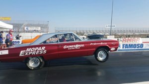

Stock stuff here except for tie rods. Save the money for good shocks. You'll be way happier. Been 1.240 60ft on the stock front stuff. Car runs 145+
Doug
I run stock front suspension, torsion bars and all.
I have Calvert 90/10 front shocks.
CalTrac wants 5" of free travel on the front end with their complete setup in the Rear (Mono Leafs, Bars and CalTrac 9 way Adj RR shocks)
so I unscrewed the torsion bars and let the front end "sag"
When I put a floor jack under the K-Member and start jacking the car up, my front fender comes up a full 5" before the front tire lifts off the ground...walla...5" of free travel.
IT WORKS for me. Off the transbrake at 4000rpm the car pulls the front wheels about 15" up for about 20 feet out...cant complain about traction.
