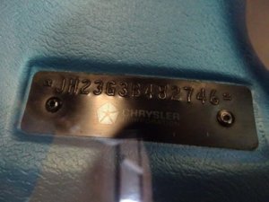

ruh row
Better check the body numbers.
...but why would you VIN swap a 318 car?

Round VIN plate rivets, what's going on here???
It could be as innocent as they removed it to redo the dash and re-installed with regular rivets. I doubt the restorer is a Mopar guy and knows the rivets were special as the engine compartment is black :(
