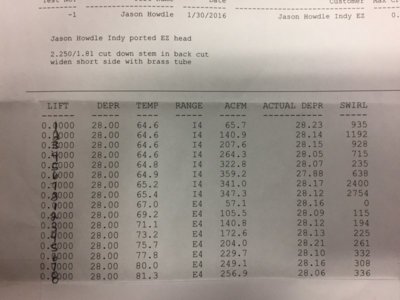

Here are the flow charts from each head. The 2.25 head is the one that failed. The 2.19 head is the one that will go on.

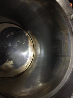

Well the plot thickens. Pulled the D/S Head today and see scoring on #7. It isn’t terrible. But I can feel it. Pretty sure it’s not going to stay the same that it will get worse. So the 440 with the blue bottle may be the viable option this year.

#7 is scored in my 511, so it’s a boat anchor for now.

It depends on the oil band. You need to make it doesn't uncover at the base circle and at full lift. You can do the math or put the cam and lifters in with no intake. Put the drill in the oil pump, turn the motor over slowly by hand and watch what bleeds. Before i did anything I'd pull that piston and have a look. See if the ring lands and skirt are all beat up. If was just a piece of debris that got caught, I'd clean it up and run it.

That is the second time for hole #7. The skirt was not great the first time. My shop figured they could save it. Obviously not. However #5 was bad last time and it seems ok right now. Porter says sleeve it and run it. I’d still have to order 1 piston for sure.
So for now it can sit till I make a plan.
