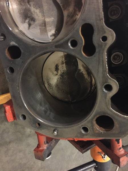

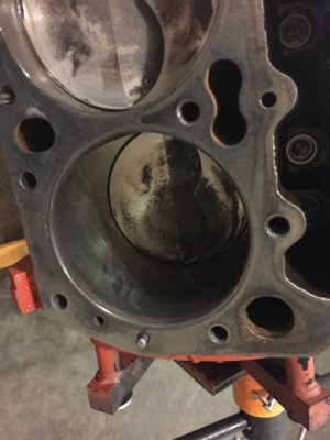

Well cylinder walls in the 440 look great compared to the 511. The solid cam is on its way out. It would probably make the season but why chance it. 1/2 the lifters already have a good shine to them. So that solves it. The roller goes in the 440.

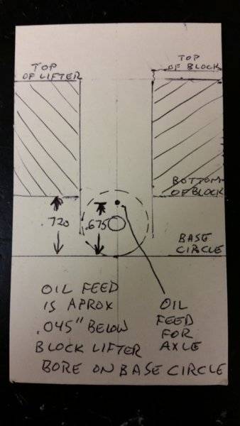

An inquiry to Jesel tells me that their lifter will work fine in a cast block or a bronze bushing. Looking at the solid EDM lifter and comparing to the Jesel roller puts the Oil band in the same place. I have yet to slide the roller cam in the 440 but a quick test shows the Jesel Oil band to be below the top of the lifter hole. The roller does have .040 more lobe lift so will have to check once it is in the block.

It looks like it will be fine, but until I get the roller in the block I won’t know for sure. How much lower should the Oil band be in the bore at max lobe lift to be considered ok to use?
Wow, ya know, I've never tested that. I have an engine on the stand that I may be able to test it today.
Anyone have a measurement of the roller on a Comp 829?
A Jesel is .825. I’ve been told a Comp is .750 but looking for confirmation on that size.
The Oil band on the Jesel does not look like it will be an issue at max love lift when I pull the oil gallery plug and shine a light in.
At max lift the groove is about 2/3rds in the top of the bore, but there has to be between a 1/4-1/8” of lifter body before the Oil groove would be at the top.
BUT...... at max lift at the bottom of the hole, the lifter body is VERY close to uncovering where the roller is.
So that is why I am curious what the roller size is on a comp 829?
Smaller roller means the lifter body sits lower in the bore does it not?
IQ am I on track here or out to lunch?
I belive my Isky are the same wheel diameter as my Comps were, .810" . Not sure what the base circle of your cam is. Mine is a .470" lobe Comp. The back side of my cam is .720" below the bottom of the block. Here's a drawing I made. Disregard the measurement for the oil feed hole as this was an Isky lifter.
